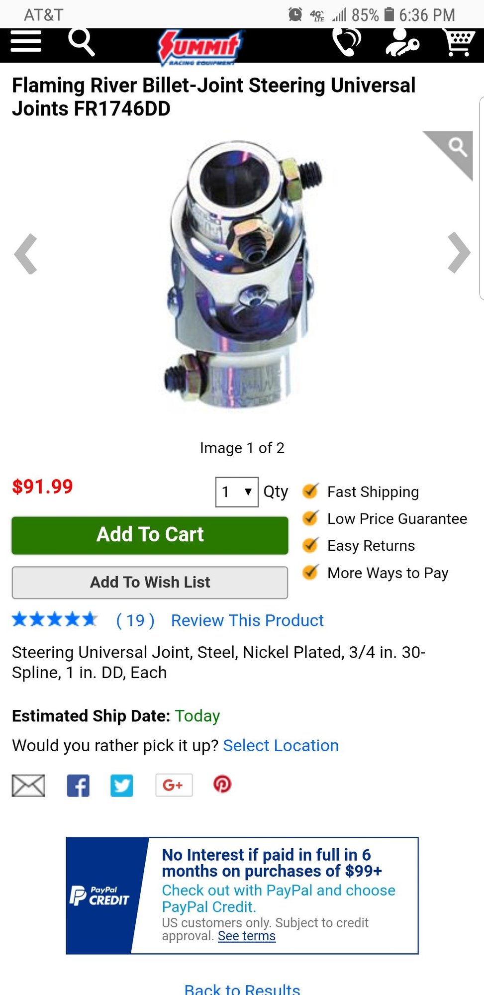

I've done the flaming River u joint mod to my truck. It's been about a year, and I haven't had a single issue. It's fairly easy to do. Just follow the instructions on the link above. I think there's a thread on this forum, as well.
I got the part number mentioned in the thread from summit Racing. I'm lucky to have a store close to me, so I was able to pick it up the next day
Edit: this is the thread I used. Followed it exactly, didn't have a single issue

Can you confirm the part number and post the end specifications for the u-joint used on the Blazers? e.g. the diameter and spline count for the end that attaches to the steering gear shaft, the size of the end that attaches to the intermediate shaft?

I don't remember the measurements, but I do remember ordering the exact part # as in the thread, and it being correct.
Edit: maybe I can look up my summit order history
Looked up my order history. This is the exact one I ordered, and it fit my 1995 Blazer perfectly.
