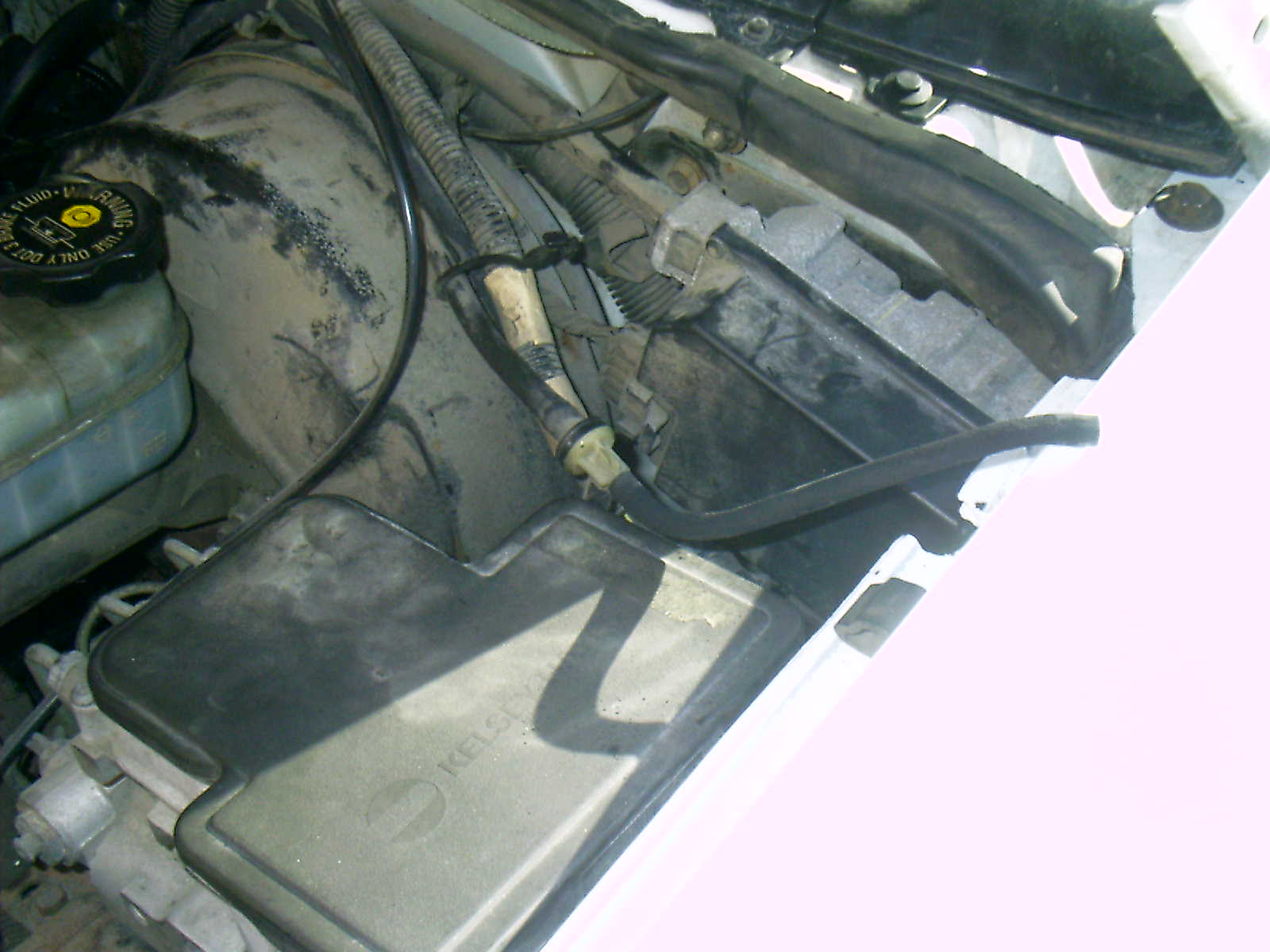

I found a hose off. Here is a link to a photo that is identical to my issue could this be my problem, and if so where does it go/location? http://www.kylestubbins.com/files/images/IMAG0025.JPG

Old Jan 19, 2010 | 09:03 PM
Posts: 41,345
Goes into the vacuum reservoir which is located inside the driver side fender right in that general area.
