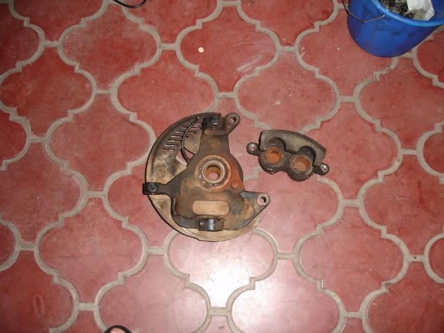

If you have about $200-300 to sink into the front and a good amount of time, I'd recomend this, if not, thats fine, too. But to put in a 33mm sway bar from the suv, is theoretically simple. what you need is a set of LCA's from the newer vehicle, and the bar itself, including bushings and endlinks/hardware (or get new stuff). Now, I would junkyard shop if I were you, because its a one stop shop once you find a donor. And since you have to yank them anyway... why not get a 98+ SUV's 2 piston brakes. Thats right, 2 Piston calipers. bummer is, the calipers are nowhere nere direct bolt on. you need the whole spindle, and keep the lines intact, too. Anyway, get the spindle w/brakes, Lower Control Arms, and 33mm Bar, and retro fit it to your 1st gen, and you'll get a heluva improvement in handling and braking. Also, control arm bushings, balljoints, and endlinks/bar bushings would be a good idea.

all I have is the brake setup thus far, keep ya posted on my progress over the weekend.
** So I'm headed to the Yards tomorrow with a pretty hefty list. I know exactly where a decent amount of the parts are, though. So that helps. Hope I have good luck with it. I just prepped and painted the parts I had tonight, look pretty good! More to come..**

You can't swap just front sway bars unless you've got a 2wd. For a 4x4, you need lower control arms as well. I am adding a rear sway bar as well. I will be welding in the brakets for the rear end links. Someone said you could bolt them in (???) On the 98 donor 4dr4x4 I found you have to cut the brackets out, so you have to weld them in the new car. I will also be swaping over front spindle assemblies, switching to the 2-piston full float calipers, and also the sealed bearings with easy to replace abs sensor. Hopefully I can get the abs to work like this, or I have to swap hubs/splash sheilds.
