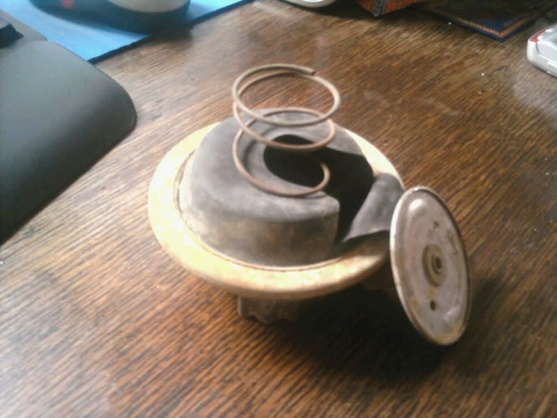

pulled the battery and battery tray so that i could use some vice grips to check to make sure the 4x4 works and this is what i found....
Old Feb 24, 2010 | 01:10 PM
Posts: 41,334
That would explain a few things. While you are in there, lubricate the cable and work it to get the lubrication all the way down the cable. This will keep things working properly for quite awhile after you get that issue fixed!
