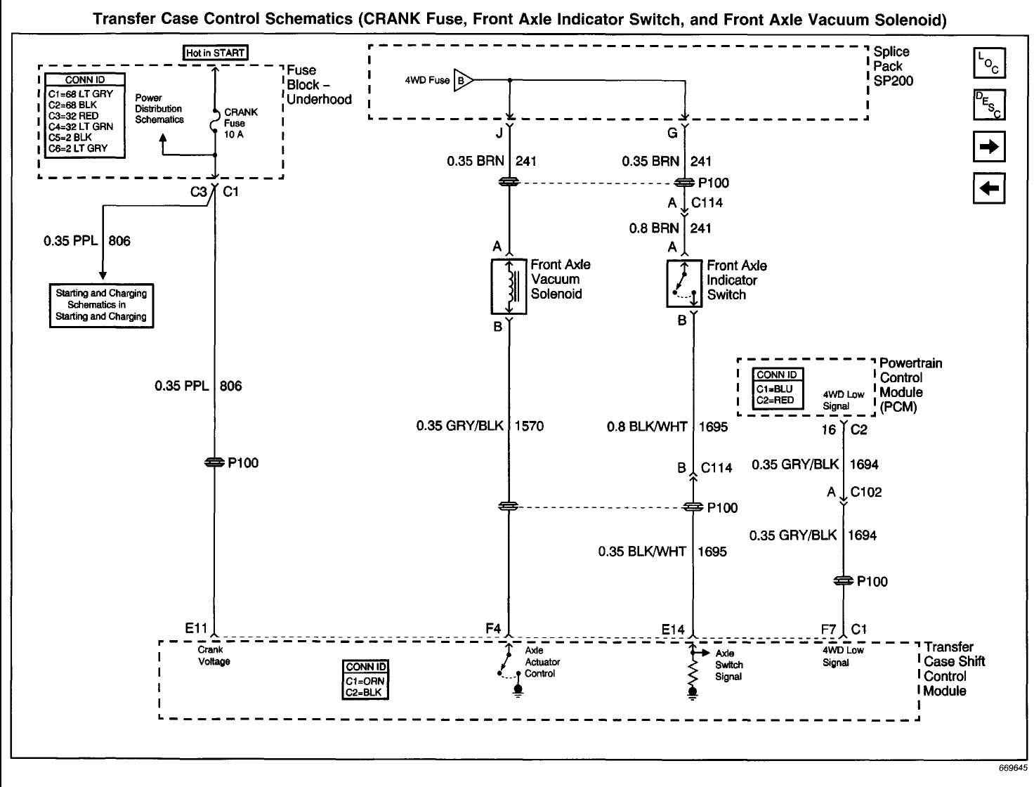

  1. Disconnect vacuum solenoid electrical plug and probe brown wire with test light connected to ground. Should have 12V. If not, check 4WD fuse.
  2. If #1 is OK, start engine and probe the grey/blk wire with a test light connected to 12V. Push 4WD button and test light should illuminate. If not, TCCM is not providing ground (control) for the solenoid.
  3. If #1 and #2 are both OK and solenoid does not operate, then replace it.
