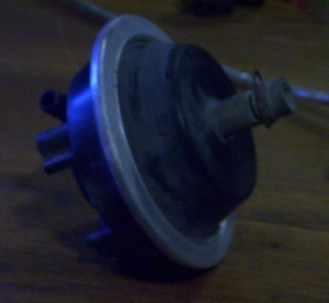

Does anyone have a pic of what this looks like, so I know what I am looking for? I have a vacuum gauge and can check vacuum if needed, I just don't know what it looks like?
Old Oct 27, 2009 | 12:21 PM
Posts: 41,341
In that reply, switch = actuator. There are plenty of pictures of this spread around on the forum. It is a black plastic vacuum diaphragm with a vacuum hose in one end and a cable attached to the other end. Hard to miss.

Heres a picture of the actuator i posted it in another thread a while back but here it is again. Like its been said its under the battery tray. just put your finger on the end of the hose and see if its working. Also check the actuator to make sure its not torn or anything. You will want to pull on the cable also to make sure its not seized up from being rusted or anything also. good luck

Fixed it, to get the truck running while removing the battery and tray I ran jumper cables from the battery next to the truck to the terminal wires on the truck, making sure the positive side was insulated from grounding on anything.
With the truck running, I pushed 4HI, nothing, like usual, so I pushed in the diaphram on the actuator myself all the way in, and viola! It worked!! I think the actuator was just sticking after not being used for a few months. After that, it began functioning as normal!
