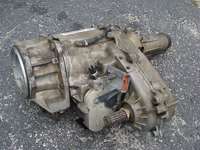

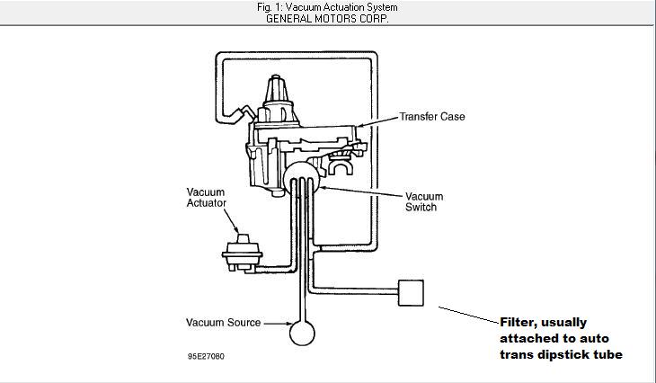

With the engine at idle, transmission in park or neutral, select 2WD: check for manifold vacuum on one of the three lines at the vacuum switch. Located on the driver side of transfer case, inboard and slightly above the front output shaft:
Check the integrity of the 2 remaining vacuum lines:
Edit: During electronic shifting, (mode shift & range shift) the TCCM checks the encoder motor operation. If the encoder motor does not function properly, the TCCM stores an encoder motor DTC 2. Usually this means there's a problem with the encoder motor or its associated wiring.... bad motor, short or open circuit to the encoder motor, poor connection, etc etc. If the encoder motor is not shifting the transfer case, the vacuum switch will not be able to direct vacuum to the actuator under the battery. If the transfer case is not shifting, and constantly in 2WD, you'll never see vacuum at the actuator, and the right front axle will not lock in.
