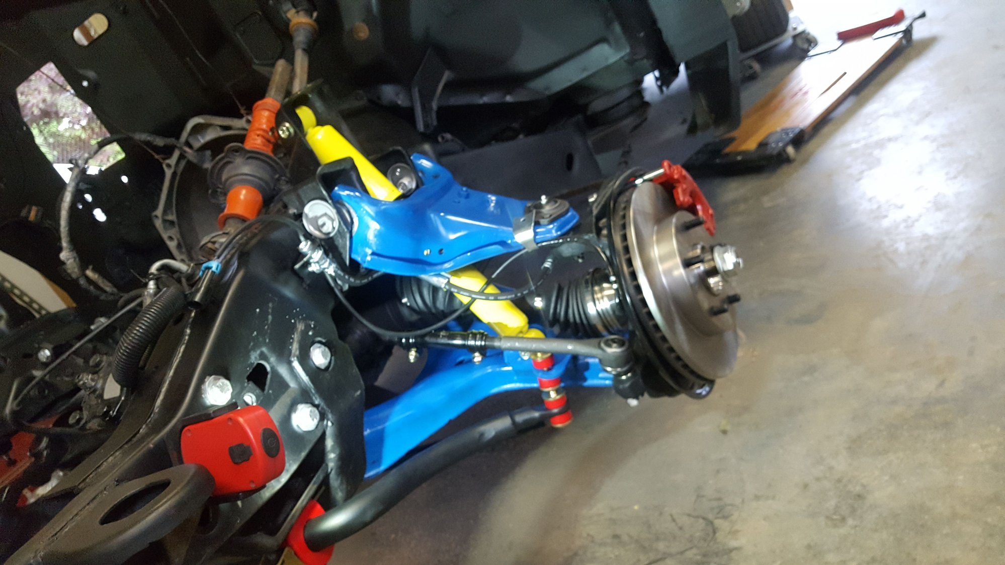

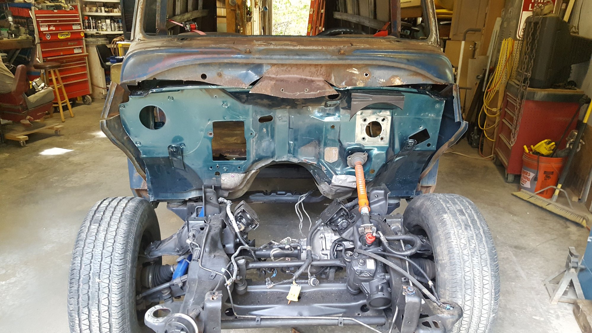

I'm gonna say that the keys might have been over tightened when you got it (Pic is a pic of his mid project, it's the old blue dodge we used to see). I would loosen them all the way, check the position of the front end, then tighten them to bring the front back up to "level".
It's going to be hard to have specific measurements, as it's custom work. But we might be able to help get the front ligned up better...

Old Mar 11, 2022 | 08:27 AM
The driver's side looks pretty good. Do you have a picture of the problem you're having on the passenger side for comparison?
