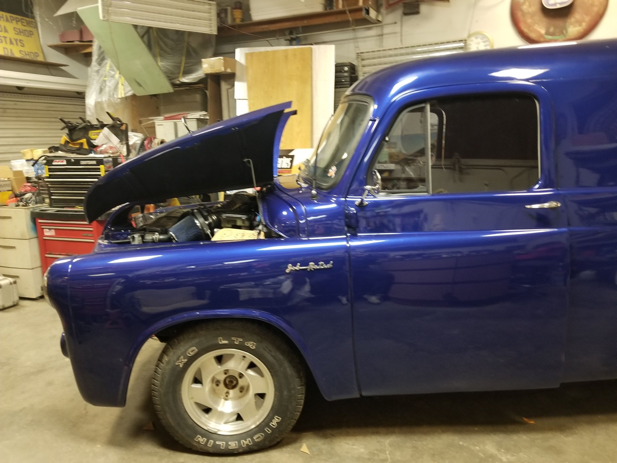

From the body off pic, it looks like the passenger side is way higher then the driver. But like Tom asked for a pic, it'll be a lot easier to tell.
Any up to date pics with the body on?

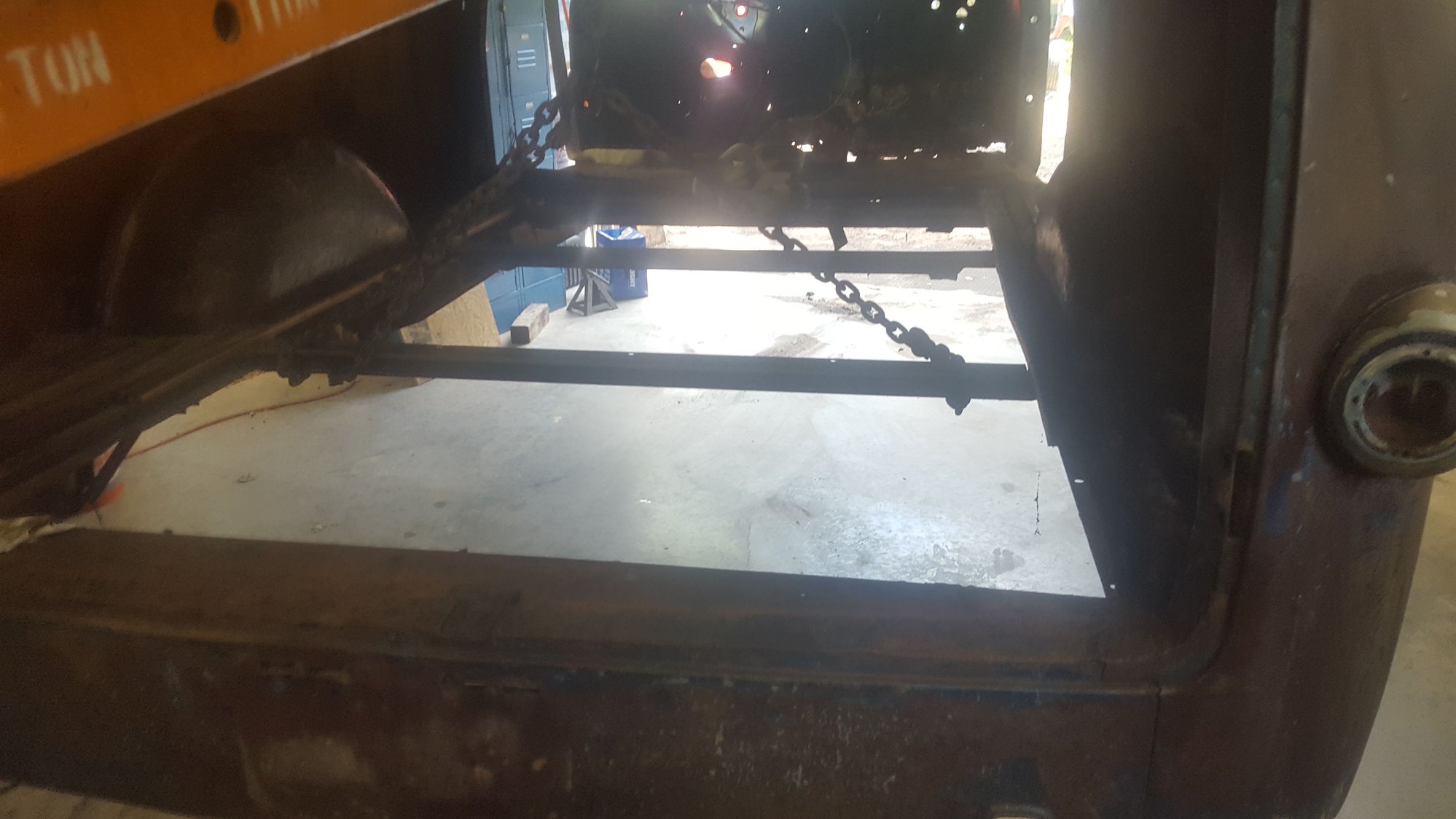

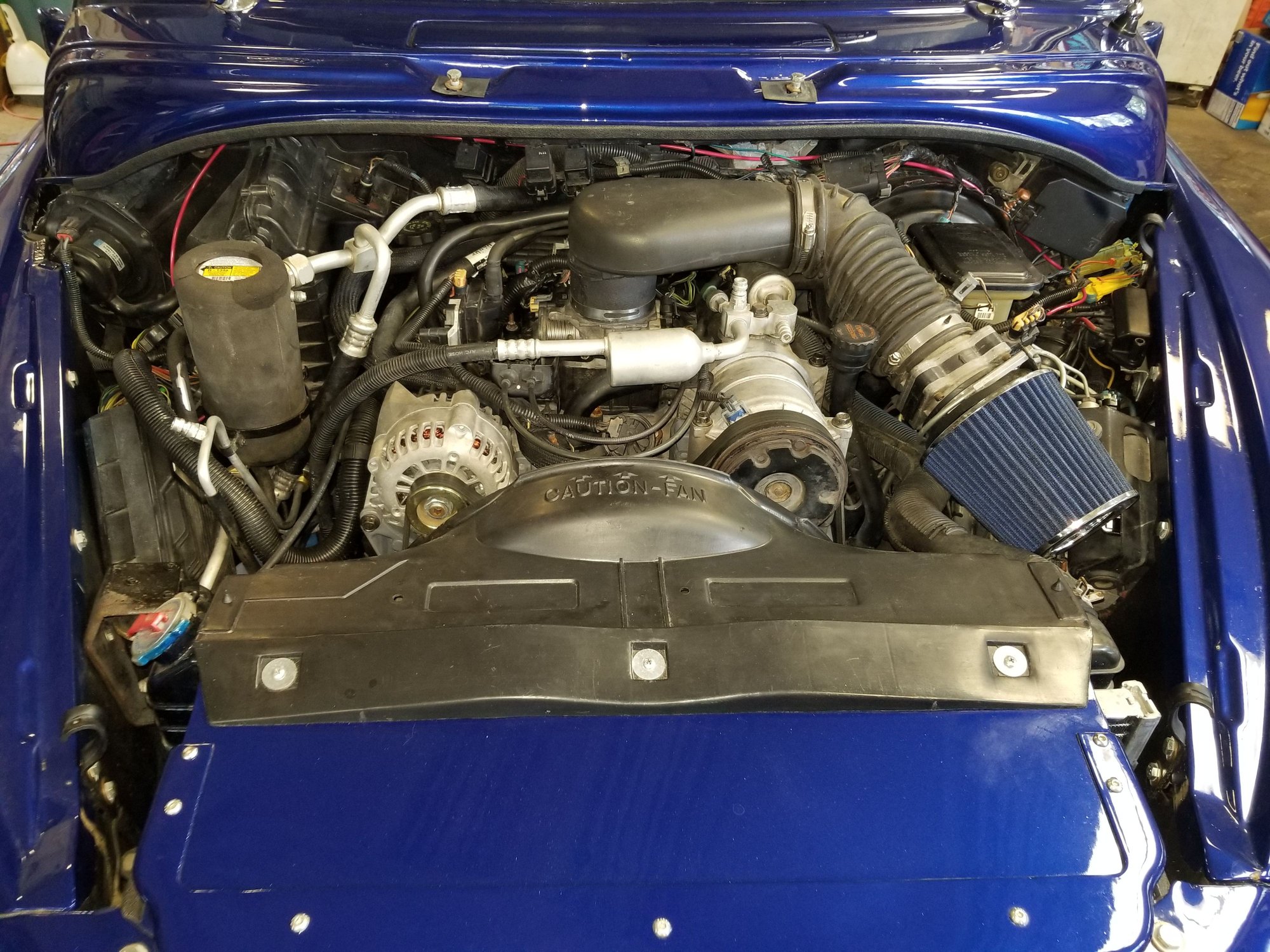

4.3L fi, had to fabricate a core support and battery placement behind rt headlight.
Adding blue lites under hood and separate switch 4 under cab lites.
Back doors, sorry it shows fat boy painter

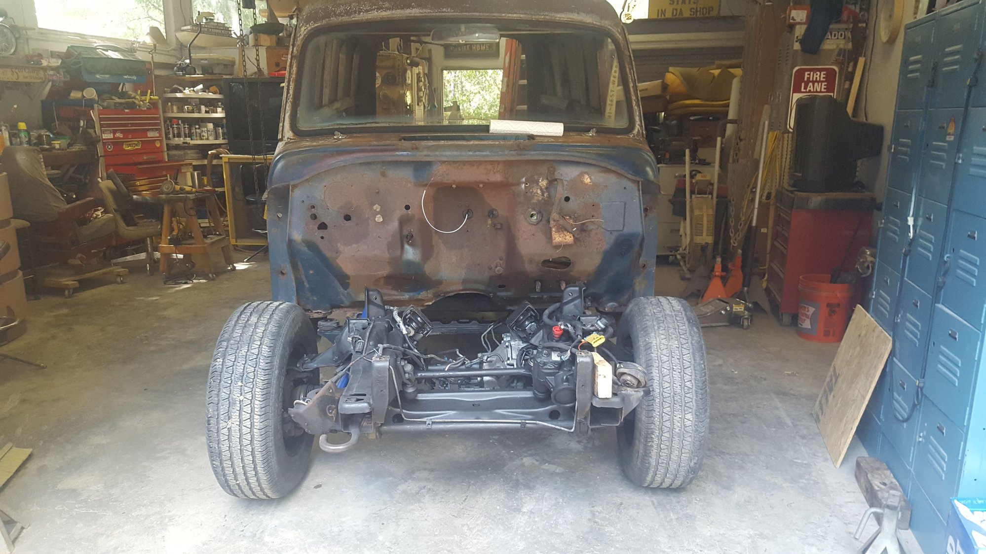

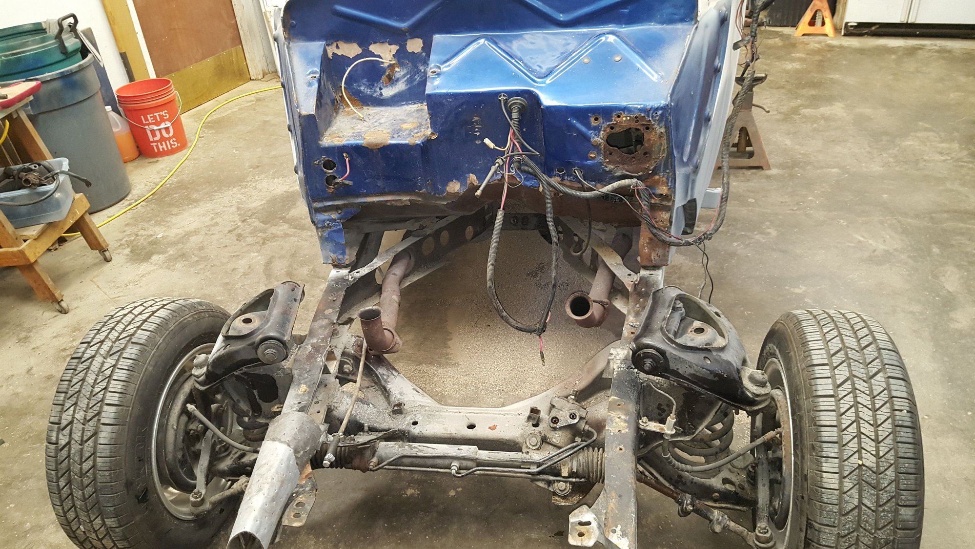

I did not take a close up at that time.
This is still as i bought it...
About to exchange firewall and fitting for cuts

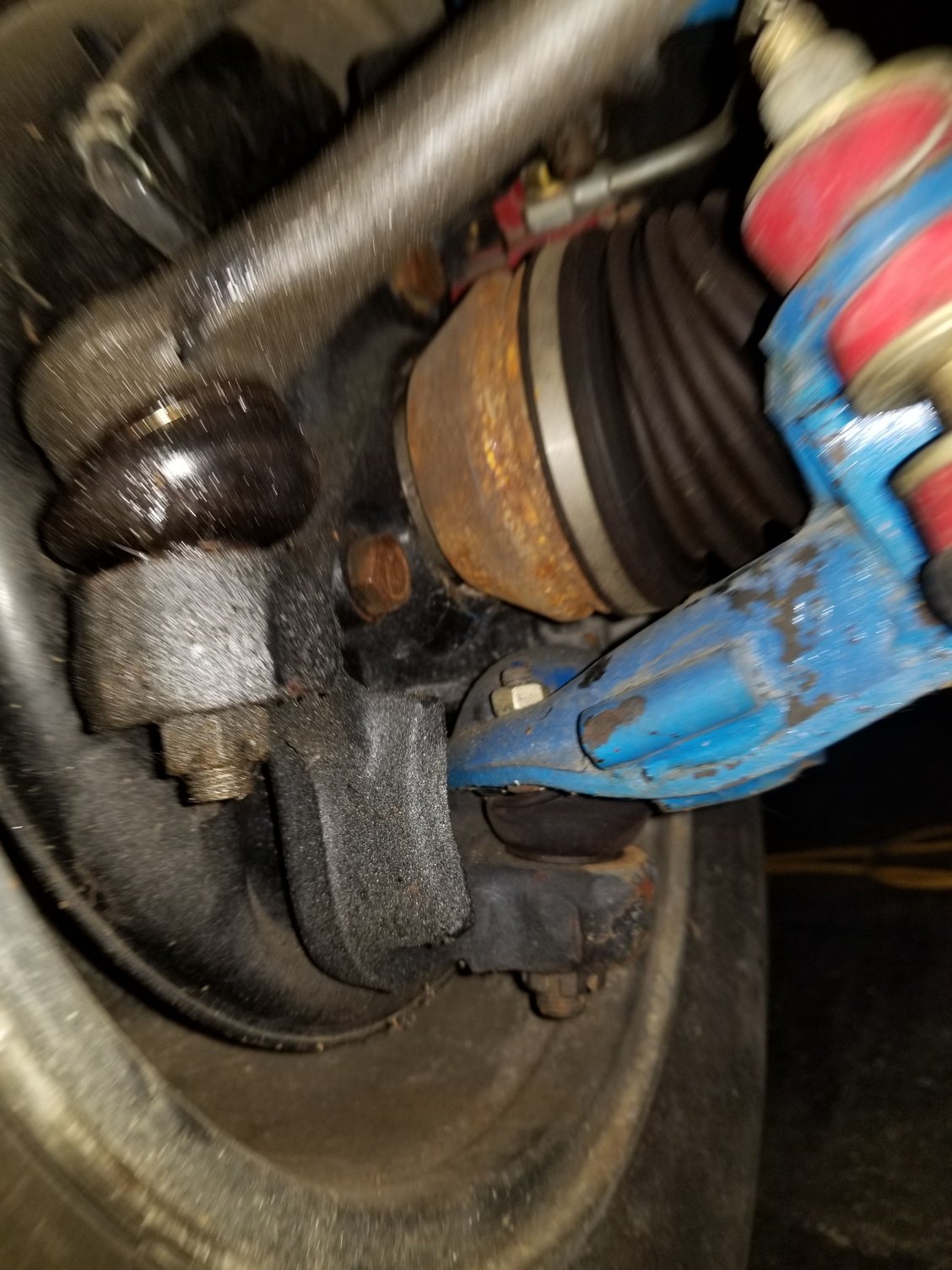

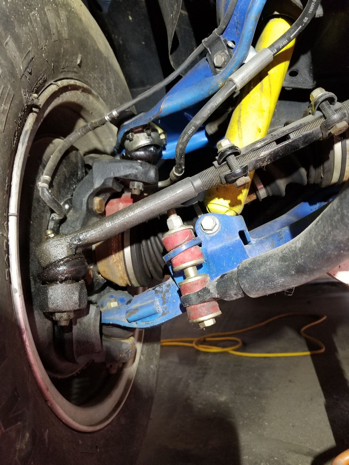

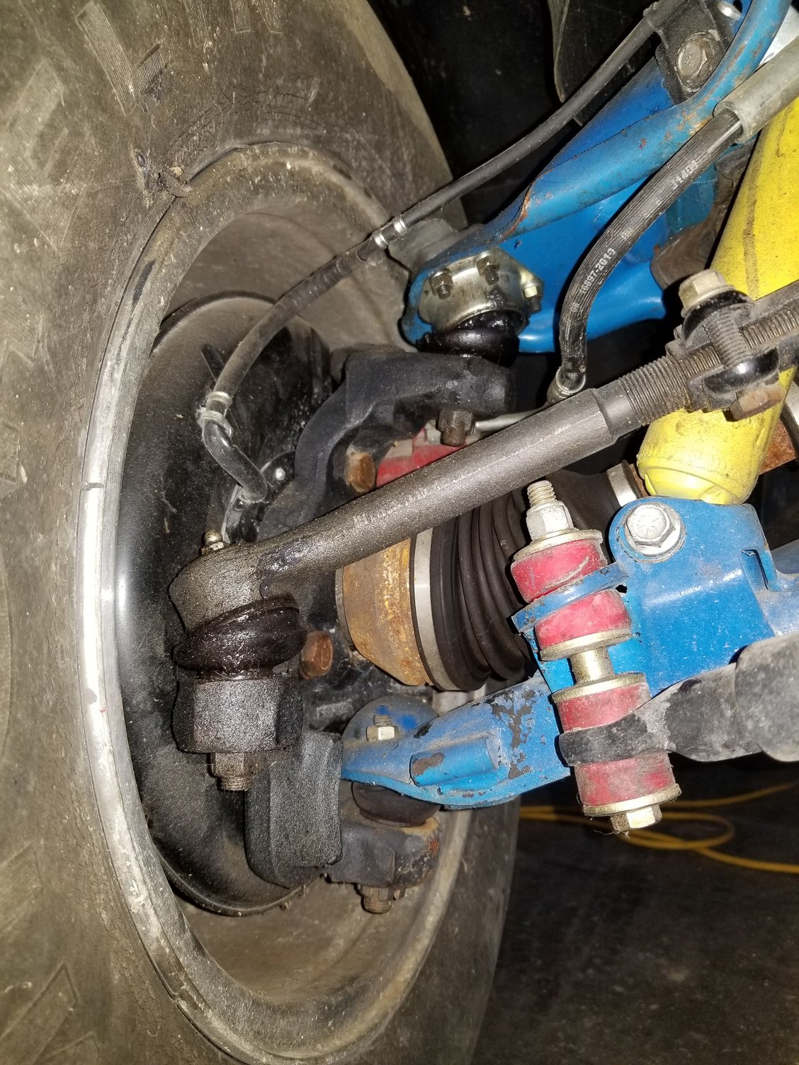

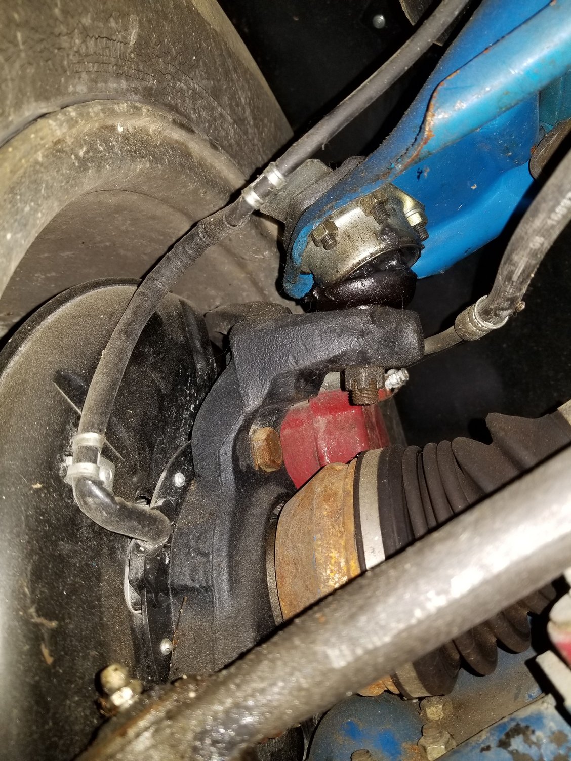

Passenger side
Please notice upper ball joint angle and boot is separated w/1 mile driven
Old Mar 13, 2022 | 02:22 PM
To me, that does look like it's sitting up too high. The tie rod and the CV ale angles are pretty steep, too. It's hard to see the bump stop (the one that limits suspension extension, but it also looks like it's close to hitting. I would lower it down some by loosening the torsion bars, and see how everything lines up.

Looking good! I'm with Tom, if you bring everything down, then start from there, should be able to get it in specs... if you loosen the torsion bare all the way, and it still sits high, my only thought from there would be the previous owner moved the torsion key, and didn't put it back in the same spot.
you might have to redo the camber angle after the torsion bar adjustment.
