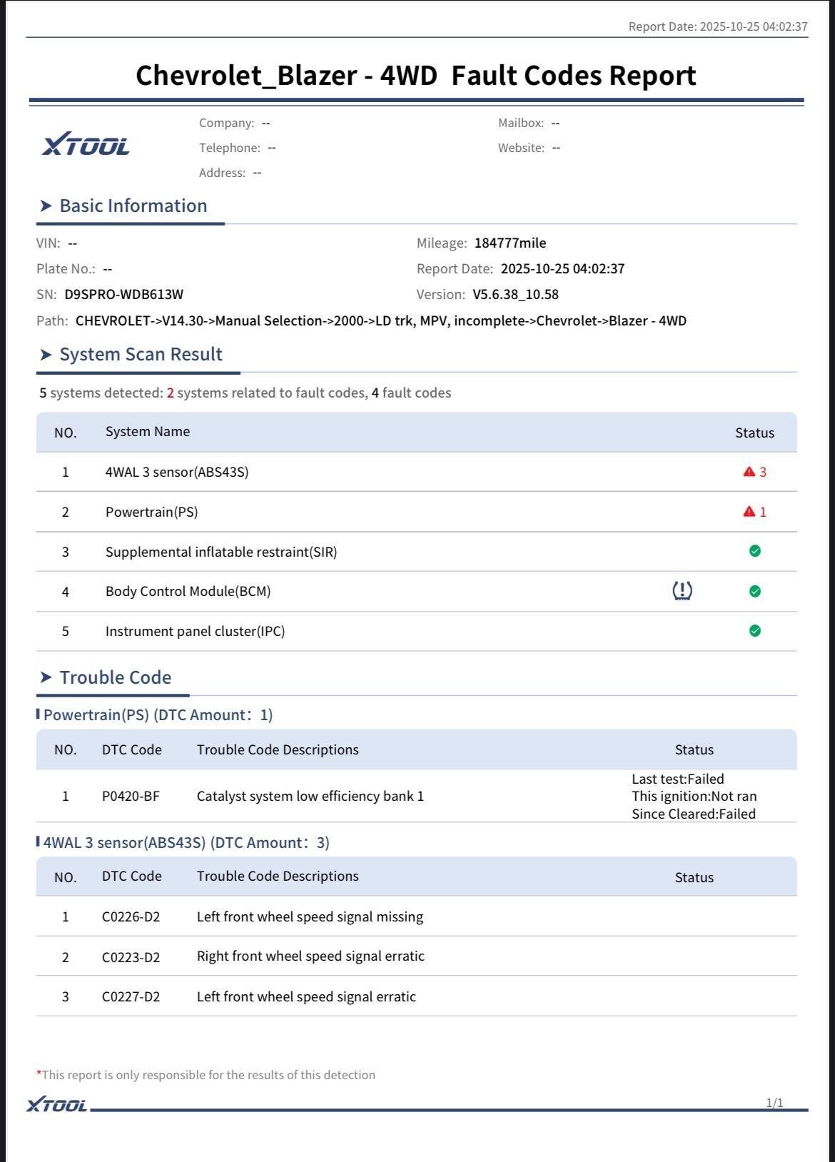

I got up to 15mph to get the light to come on and then came back and parked with car running. My friend ran his scan tool and this is what was reported.

I ordered 2 new A-Premium ABS sensors and installed them on each side of the front with 1 shim on each. The abs activation persists. I made sure they were not rubbing tone ring. Perhaps I need two shims each?
