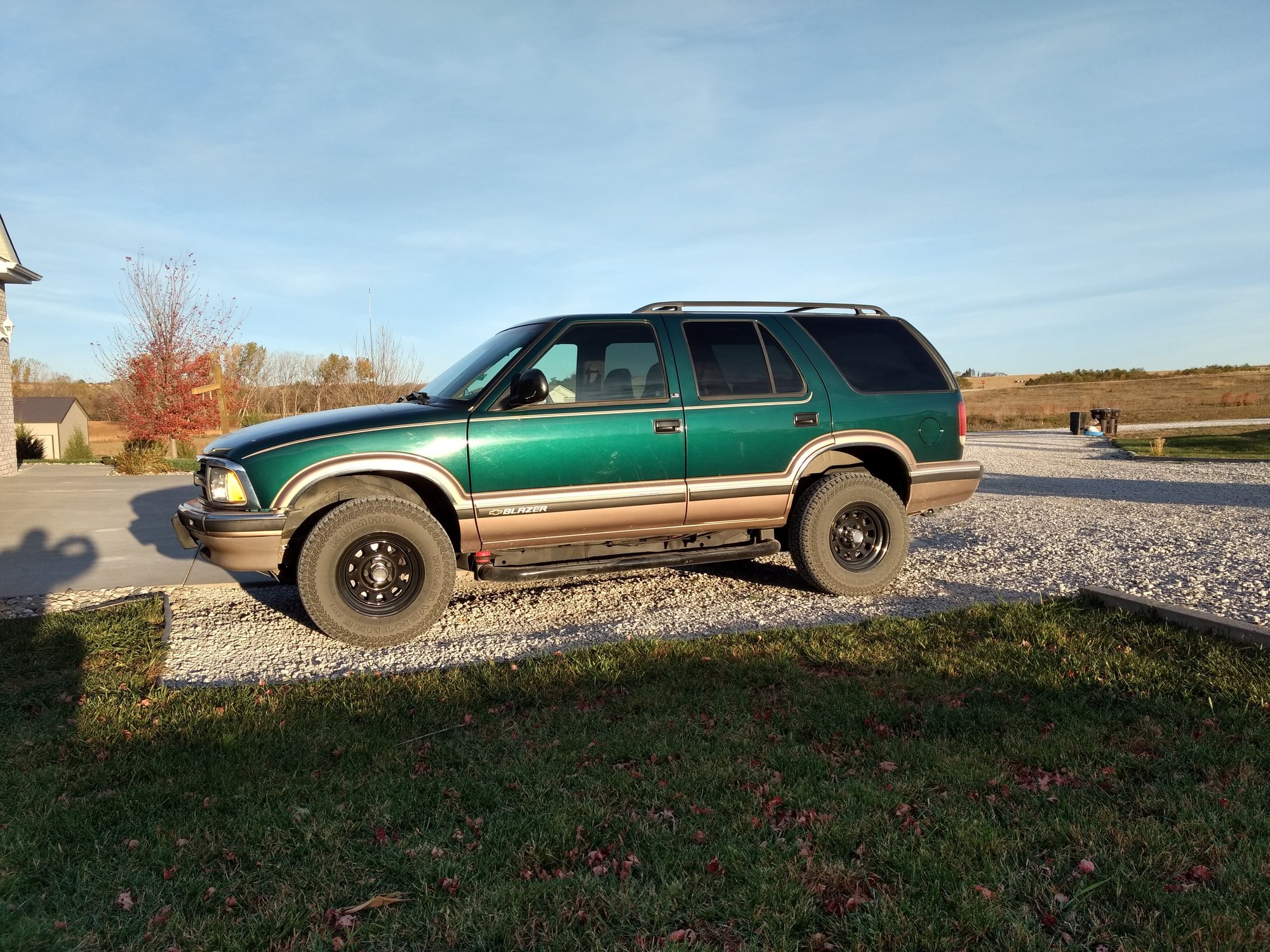

I just did this on my 96 4 door Blazer along with a 2" body lift and I went with the Prothane Motion Control replacements off Ebay and Wow what a difference. Mine didn't look that bad but I did have one of the bolts break and that was a real pain to drill and tap. I did the work myself but I do have a lift which makes life much easier. Before changing the body mounts my drivers side door would drop a little when you opened it but not no more. It also feels tighter going down the road and takes the bumps and washboard country roads way better now.

Looks really good, On a scale of 1-10, how much smoother is the ride would you say? What manufacturer did they come from? Red the only colour?

I wouldn't say smoother but tighter and you don't get the body roll feeling when going around a curve changing lanes etc. They are Prothane Motion Control and they do have them in black but I didn't see them in black for $105.
