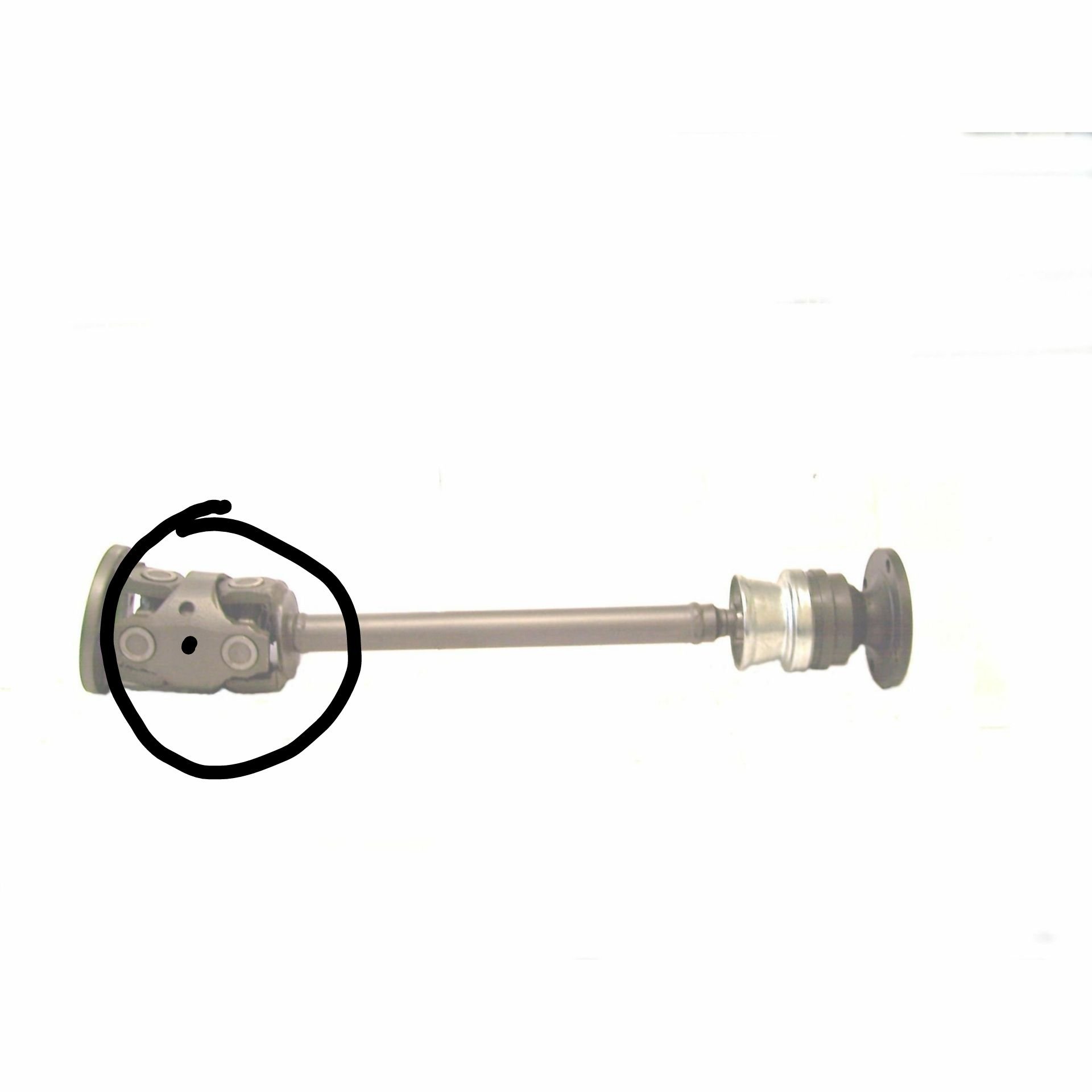

Feeling defeated here. There's some kind of link in between the front driveshaft u joints that's the actual problem. I'm tired of throwing money and parts at this. I'll have to get another from a junkyard. AutoZone wants $1,324 for one. Lel I can replace the vehicle for less than that.
Closest, cheapest junkyard is 100+ miles away, but they have it pulled. I'll just get it shipped.

What are you using for a repair manual? According to my GM service manual all the joints appear to be repairable.

It's in the circle, the part with the dot. There's a link inside that's bad. The u joints weren't the problem either. I could reach the joints just fine I could even remove them, but the link inside is what's bad. I don't know what it's called. There's a grease fitting that feeds grease to it.
