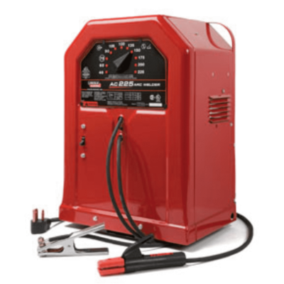

This is probably the best way. If that's not in the budget, there's always the old Lincoln Locker.

You talking about welding the front diff? If so, anything specific that I need to be concerned about when doing this?

I wouldn't recommend welding the front diff. Especially with the cast aluminum housing .. It's bound to blow apart pretty quickly. You could get away with welding the rear diff for sure though. It'll skip a bit around corners and you'll chew thru tires more quickly but it would be tolerable.
I believe there used to a posi trac unit available for the front diff. Don't remember what company it was from though.

Weld the spiders together only if you NEVER want to turn corners - 1/4 mile drag racing in a straight line and it might last a few runs before blowing apart -
If your running in the deep boggy conditions as in your avatar picture shows even all four pullinisn't gonna help you much - 4 wheel in teams so you can help each other and spend your money on good digging tires and a winch.
OH and deposit you paychecks in a good savings account to pay for the damages and abuse you are putting the vehicle thu. Fun is fun abuse is expensive .....
