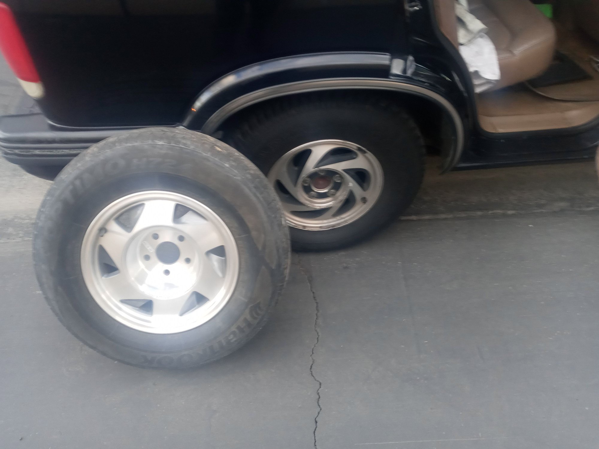

I have stock rims now but found a better set another
15in rims

Those are nice and clean.
Also they are 2wd rims, so they will stick out in the front a little, and flush the tire with the body in the back.
