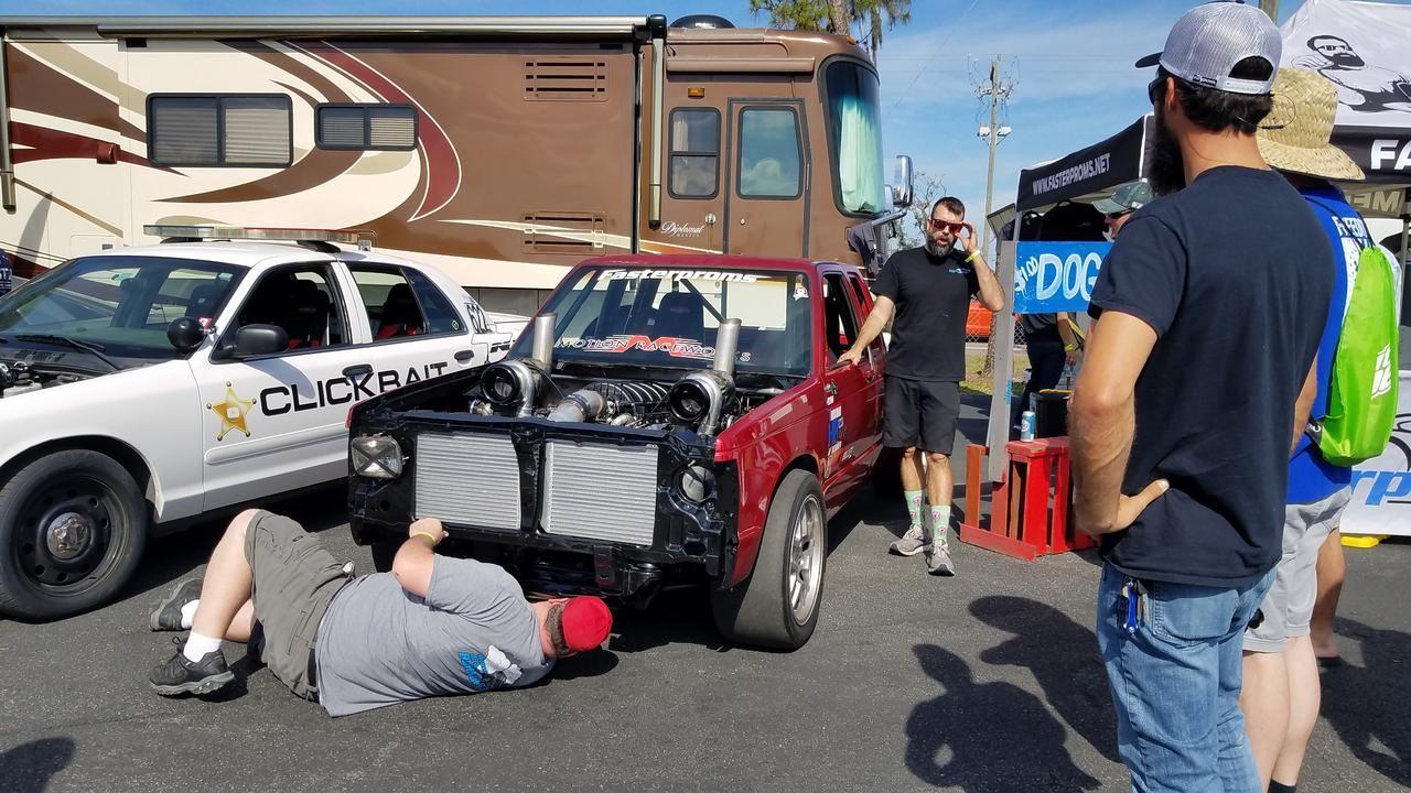

There's a dude on YouTube that's got a build I've been watching, building a wicked twin turbo LS AWD old body style S10, and so far he's using a stock TBSS t-case and stock S10 front carrier. Not sure how that carrier is holding up to the power he's putting to slicks, but it is lol
