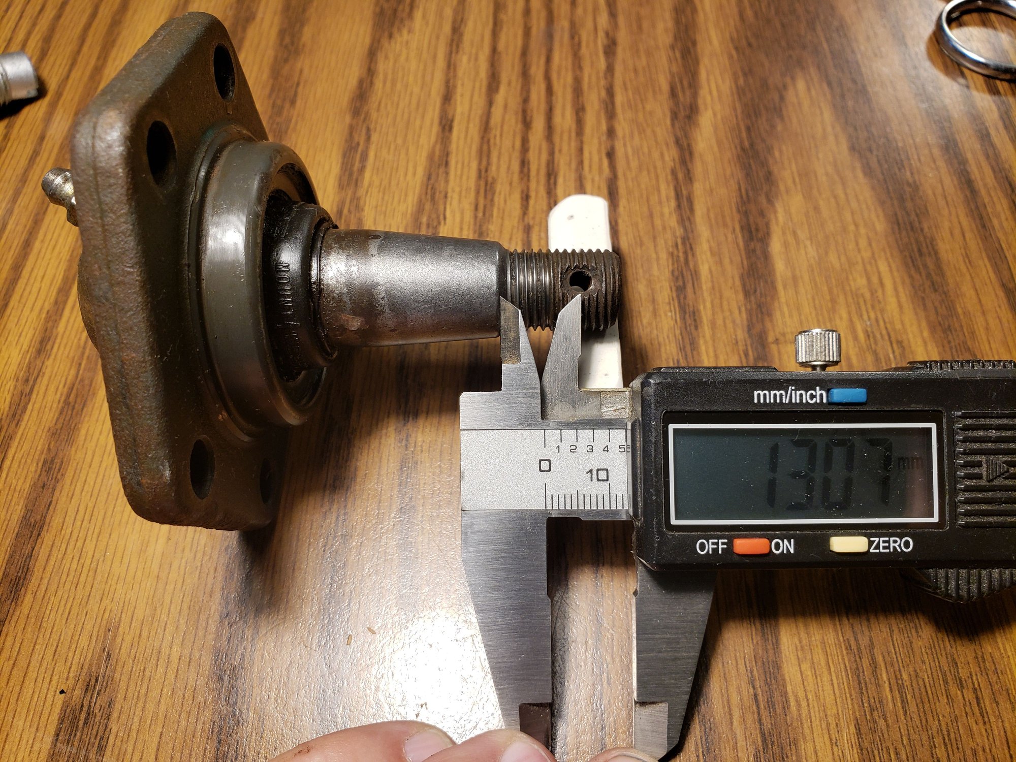

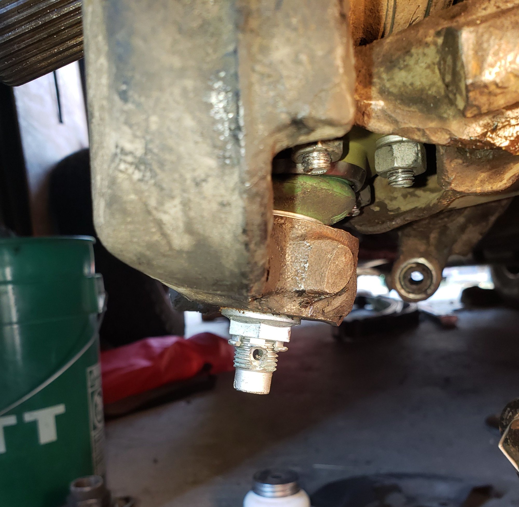

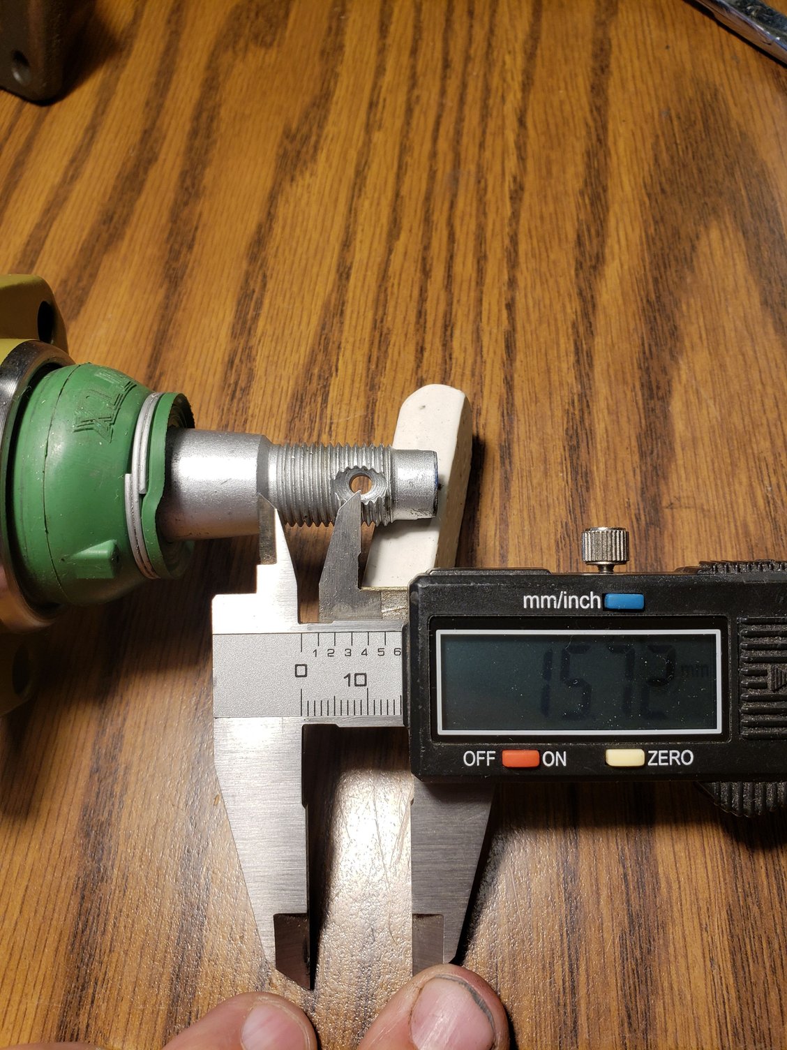

The problem is that the hole for the cotter pin is too high on the stud and the stud is longer than needed. You can see the issue in the first picture where I have installed the ball joint and had done the initial tightening of the nut so that it was snug but not torqued to is final specified value. By my best guess is out of position by about 2mm to 4mm. The comparison was made to the old Moog ball joint I was replacing as measured from the top of the taper on the stud. The OD of the top of the taper on both ball joint studs was 16.6 mm.

The installed new Mevotech ball joint with the cotter pin hole too high to engage the nut castellations.

The height above the top of the taper to the hole on the old Moog ball joint.
The height above the top of the taper to the hole on the Mevotech ball joint.

That sucks! Looking at it though, that castle nut looks way shorter than what I would expect. Wonder if they were shorted on their normal nut and some bean counter said use this one instead. I'm not saying that it is right, but would a heavy washer space it enough to get the nut to engage with the cotter pin hole?

Good eyes! I too wondered about the nut and as it turned out it was the same height as the Moog one with the castellations of the same size.
And yes, the stud is longer too. It is as if the engineers added extra length to the base of the threaded part.

did you end up leaving them in and washering down the nut

Regarding the nut, I too wondered if it was shorter than normal. So I checked and and the Mevotech nut was the same height as the old Moog one.
As for using a washer as a spacer, that is what the guy on the phone at Mevotech tech support suggested. I have thick spacer washers on the upper ball joints, but those were supplied with the Rough Country upper control arms and have the exact thickness required. I thought about trying to find some washers but then realized finding the right thickness in one or a couple would have been too hard to get right.
I didn't even get to checking any clearance between the stud and the wheel rim. However, it does stick down enough that it could have been an issue too.
