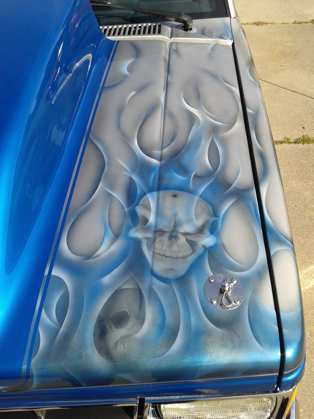

Has some airbrush work - ghost flames. Also has Eldorado tail lights and a mural on the tailgate, but not shown. A very nice amateur job. I bought it that way and changed EVERYTHING else.
