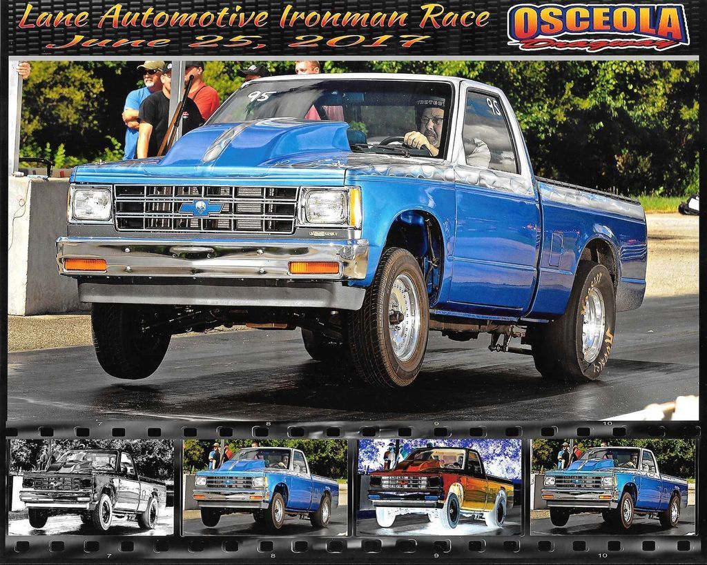

Another photo from last Summer.
I have managed to find 45 more rear wheel HP so far since November, using a dyno. Started at 345 RWH. + 30 using electric water pump and electric fan. +15 going to 1.6 rockers along with indexing and side gapping spark plugs. Now 391 RWH. Still have a Victor Jr. Intake with CNC'd ports waiting in the wings. That and tuning with the wideband is next before returning to the dyno. Had to order a new transmission - starting to slip in reverse - going with a Coan Competition TH350 with a transbrake. Should be running in the high tens this season.

Old Jan 30, 2018 | 03:28 PM
I love how I can see in your video how the motor cants to the passenger side when under full throttle. :-)
Old Jan 31, 2018 | 03:14 AM

Nice to see it race.
Have you removed the inner parts of the fenders?
Thank you. Yes, the inner fenders are removed. It is necessary for fenderwell headers, which go on the outside of the frame into the fenderwell. It's the only way to get decent full length race headers for a S10. The headers actually prevent the tires from fully turning back and forth. Good thing the race is in a straight line!
Thank you. This S10 still has the factory frame mounts with the rubber inserts, so there is a little give there.
Old Feb 1, 2018 | 02:23 AM
I guess the whole compartment is getting a bit tight on a S10 frame. The advantage/disadvantage of a truck having a frame.
You can cut out some parts but in some the frame gets into the way.
