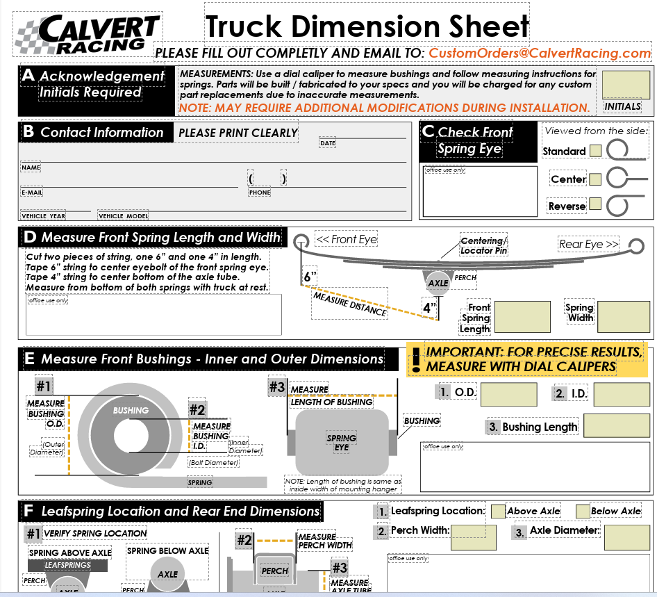

Hey everyone,
I’m working on my 1997 Chevy Blazer (4x4, 2-door, manual) and planning to do a 2.5” lift with the torsion bars fully cranked (possibly upgrading to heavier-duty torsion bars as well).
I’m also looking into running CalTracs traction bars, and since the truck is being lifted they told me the setup would need to be custom-built. They sent over a spec sheet with a bunch of precise measurements that need to be filled out.
Before I start scrambling to find dial calipers and measuring everything myself, I figured I’d ask:
Has anyone here already done a 2.5” lift + cranked torsion bar setup on a 4x4 2-door and ordered custom CalTracs?
If so, do you happen to have the measurements you used, or any tips on what to watch out for?
Any insight on fitment, pinion angle changes, axle wrap issues, or things you wish you knew beforehand would be greatly appreciated.
Thanks in advance!

I see and yes as mentioned below I am doing the RC setup, lift, and yes getting either new OEM or upgraded (if available) t bars. Probably should have worded that differently. The measurements for the caltracs were my biggest concern, mainly to reduce wheel hop, and just better drivability overall.
