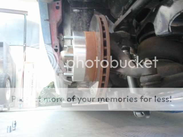

Ideally, since yours is a 4wd, you would need to either go with 4 front wheels or 4 back wheels.
But they will be very hard to pull off because of the backspacing and the size of the wheels.
Keep in mind this picture has the s10 jacked up and the full weight of the vehicle isn't on the tires. Also, this truck has no spacers and is not lowered. These wheels are not bolted on, he just put them on the truck to see how they would fit.
Good luck to you sir if you try to put these 'Maro wheels on, but it looks like A LOT more trouble than it is worth.

Oh yeah it is alot of work! I have however found a place that can build me the custom wheel adapters that I need to do this setup. I like the uncharted to be "rare" or at least not as common as your typical blazer. The main issue is that the studs on the 'maro are 14mm vs our 12mm studs and the 'maro rims are hub centric. I'm not strapped for money but I'm not ballin' either. I have the rims on semi lay away (half down) to secure my price @$780 shipped non staggered 20x9. once I pay these off I will order up my adapters and go through the trial and error. It should be a month or two before I have all the components to make this work. I plan on pulling this off just because I would love to run these wheels. I know for a fact with all this will cost I could have a set of rims and tires that would look nice, but why not take one for the team to help anyone in the future who may want to do the same thing

I found this thread the other night but it looks like the updated it. It looks pretty sweet! so all I would really need would be just the wheel adapters to go from 5x4.75 to 5x120? With a 9" wide tire and a 4x4 am I going to run into any clearance issues with back spacing in the front or rear?
