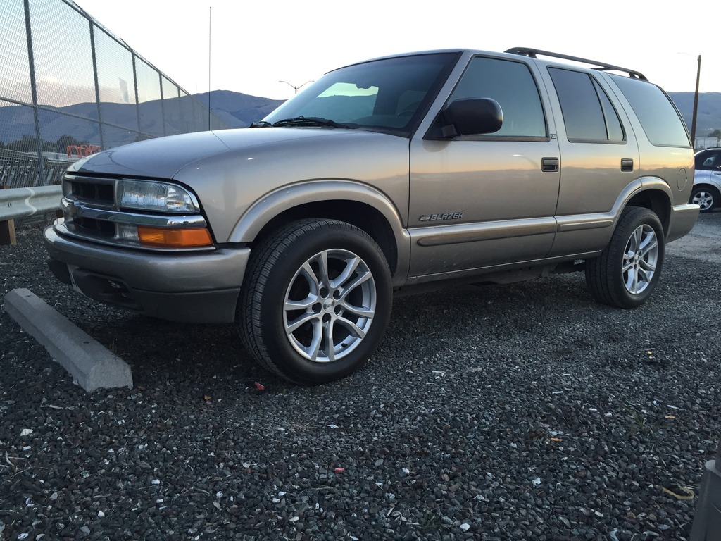

My stock tires were bald and now was the time to change my wheels.
I wanted something subtle.

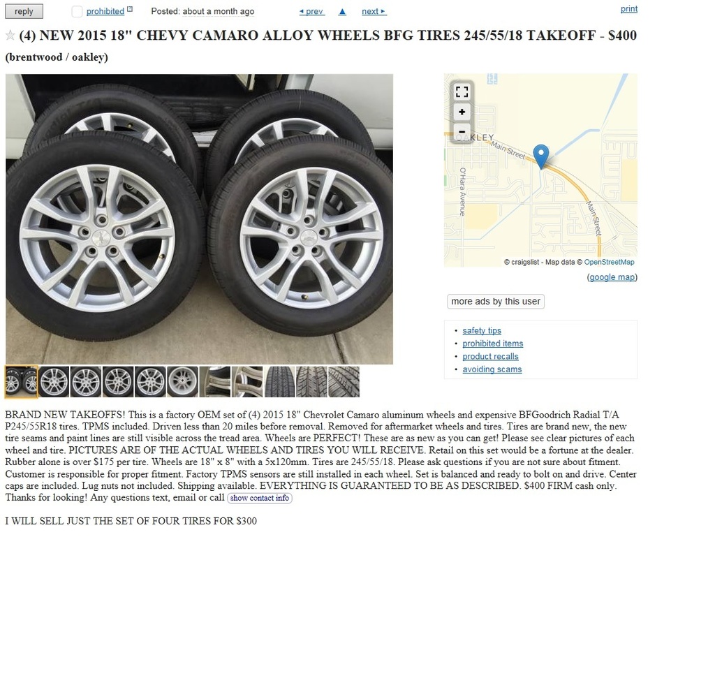

I found these take-offs on craigslist.

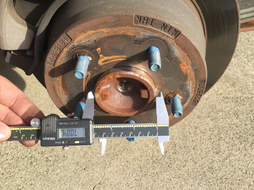

I had to open up the hubcenter of the camaro wheels from Ø67mm to fit the Blazer Ø70mm.
I used a hand grinder and slowly wittled away taking measurements as I went.
I was able to use my stock lugnuts and finish caps.
4000 miles so far with no problems.

$400.00 dollars know wonder you couldn`t pass them up..That person must have been desperate to get rid of them..Or let`s hope the rims aren`t hot.It dos look good on your blazer.Does it ride any better than with the stock rims?

Right? they were cheaper than a new set of tires!
If you look for on Craigslist, they are all over the place.
Camaro factory OEM wheels and tires

[QUOTE= Does it ride any better than with the stock rims? I can tell you that going from a 75 sidewall to a 55 sidewall has greatly improved cornering characteristics and road "feel". At the same time the ride is a little harsher ( shorter sidewall ). I used to say the Blazer was like a Cadillac compared to my previous vehicles, now it is more like an Impala SS !!
