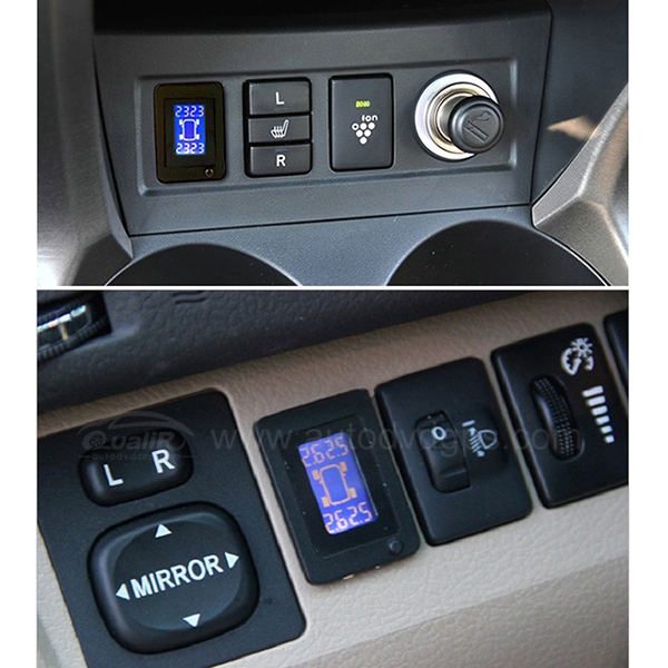

So, is there an aftermarket display that can read the TPMS sensors in these wheels?
something like this...
Old Oct 22, 2016 | 08:34 PM
2004 Blazer's Avatar
Joined: Aug 2015
Posts: 216
From: Mt Vernon/Fort Hunt, Virginia
2004 Blazer is on a distinguished road
That is a good question. The computer would probably need programming to accept the sensor data,if that is possible. Wiring would need to be run to all four corners for the sensor pick-ups too. I wonder if Camaro wiring could be adapted to the 2nd gen ECM.
