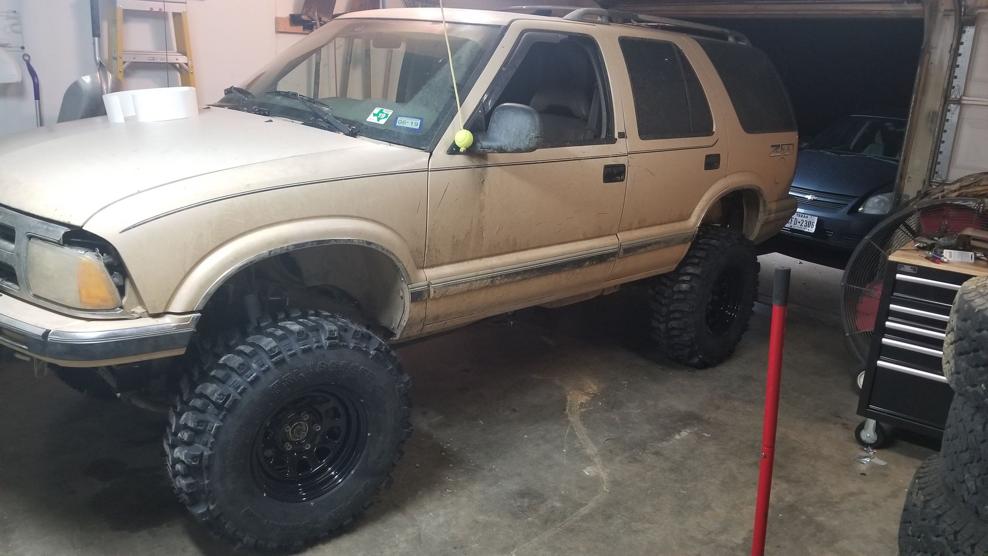

I'm running 33x10.50 on mine, 6" suspension lift.
4.5" backspacing on the rims.
I haven't tested for rubbing during flexing, but there's enough room all around the tire that I feel confident it wouldn't rub on the street.
Now, full lock rubbing, I don't know. I have the nearly the same width tire as rough country recommends for the lift kit I have, mine are 0.2" wider. Once I have an alignment done, I'll be able to tell about that

Very nice. I am assuming thats with 8" or are you running 10" wheels? I don't see any pictures in your profile. Do you have any shots of your truck with the the 33x10/5?

I was trying to add a pic just now, it kept telling me I had reached my upload limit lol.
15x8 on the rims
I'm going to take some better pic tomorrow when it's daylight. I just got the tires mounted and wheels bolted on a few hours ago.
Ive got a thread going in off roading, detailing out the lift install. I'll post pics there tomorrow evening

Right on, looks real good. I cant shell out for the 6" lift so think I am stuck with the 2" crank and 2" body. Doesn't look like I would be able to clear the front rear fender but would like to see your other pictures and how it comes along as you drive it.

What brand wheels are those the procomp 51s? What did they set you back and where did you end up getting them from. I and been looking around for more procomps like I have on my jeep that look just like those/and every other wagon wheel look -a-like haha.
