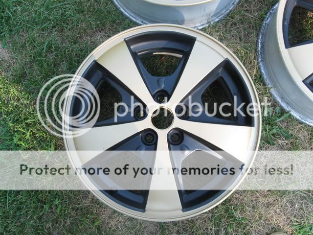

I painted the stock wheels on my old blazer and it took 1 1/2 cans of primer 2 cans of semi gloss black and 1 1/2 cans of clear. 2 medium coats of primer . 3 to 4 light to medium coats of paint. and 2 medium coats of clear. 10 min's in between coats, 1 hour inbetween primer,paint and clear. I thought I had some pics of them on the truck but cant seem to find them. Heres a pic of stock cavalier wheels I painted. Same process used.

Unlimited: WOW! They look so custom! I know they aren't blaz wheels but they would look hot on a blazer
I'll let you know how mine go this weekend.
And those won't fit a Blazer. They're off a Cav which is a different bolt pattern...
