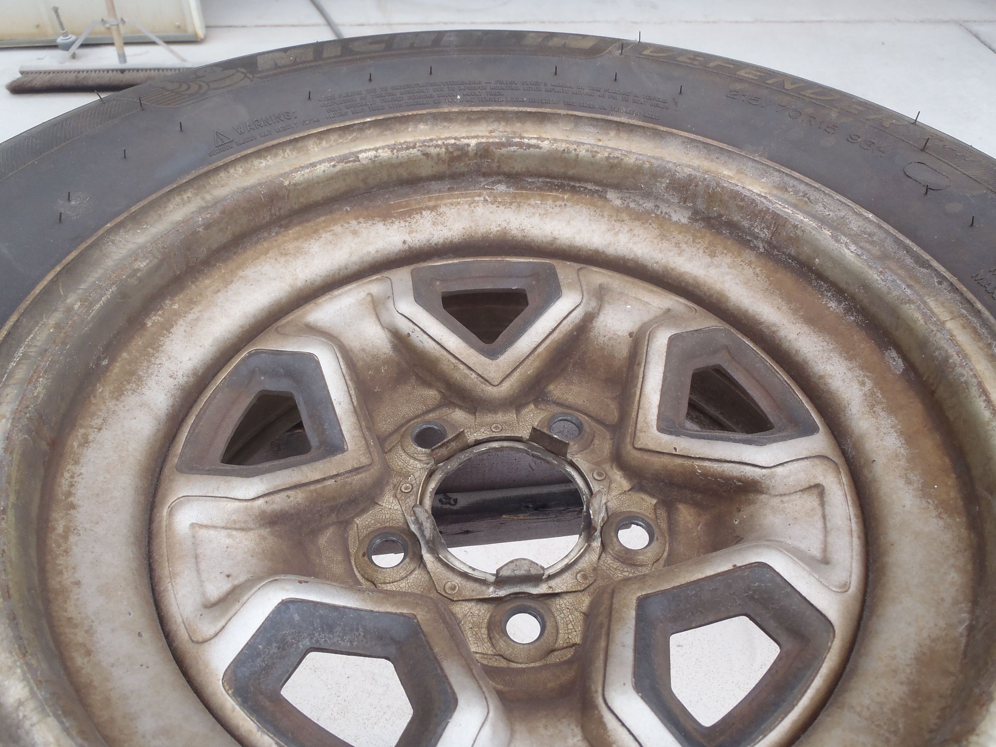

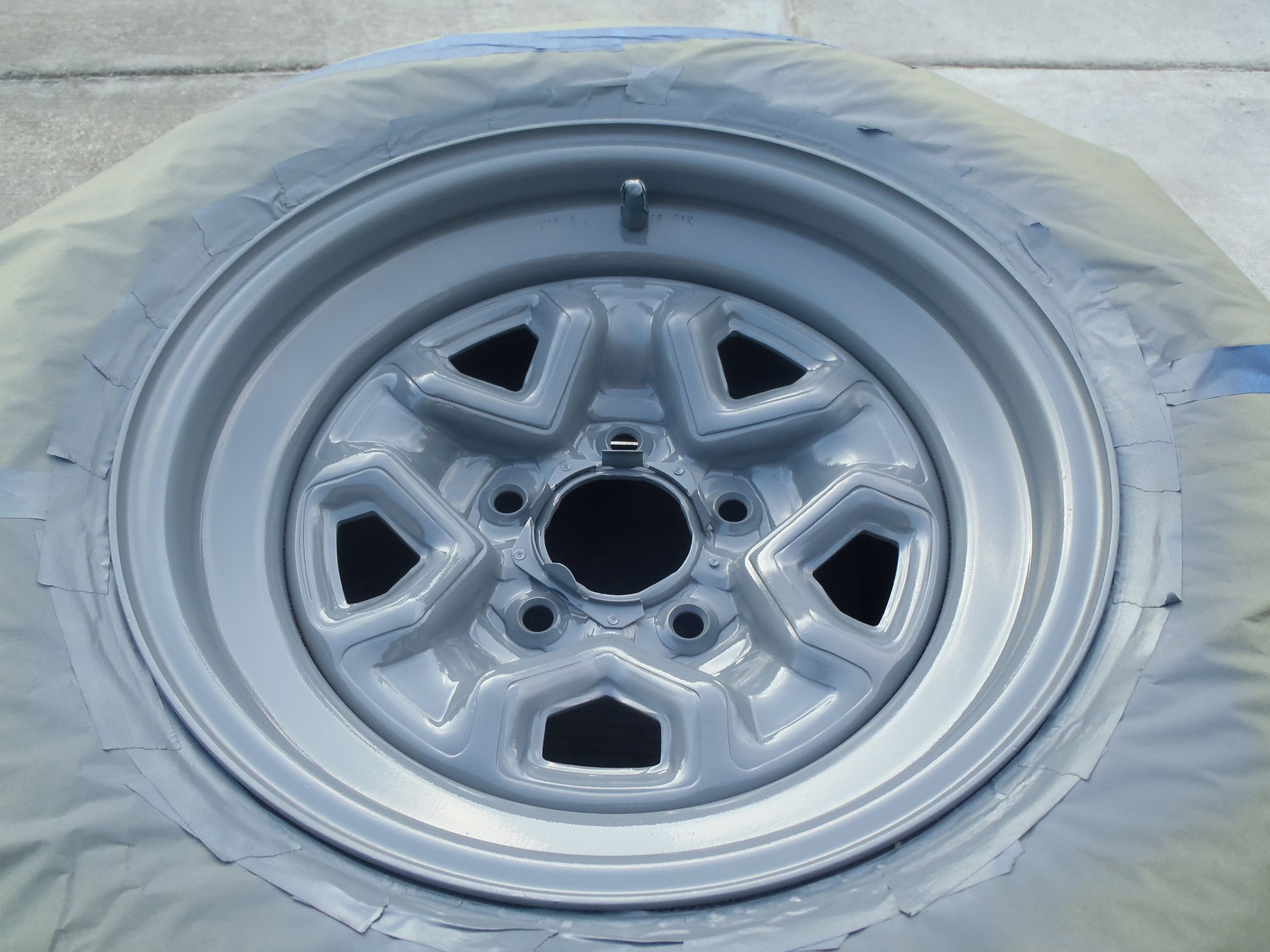

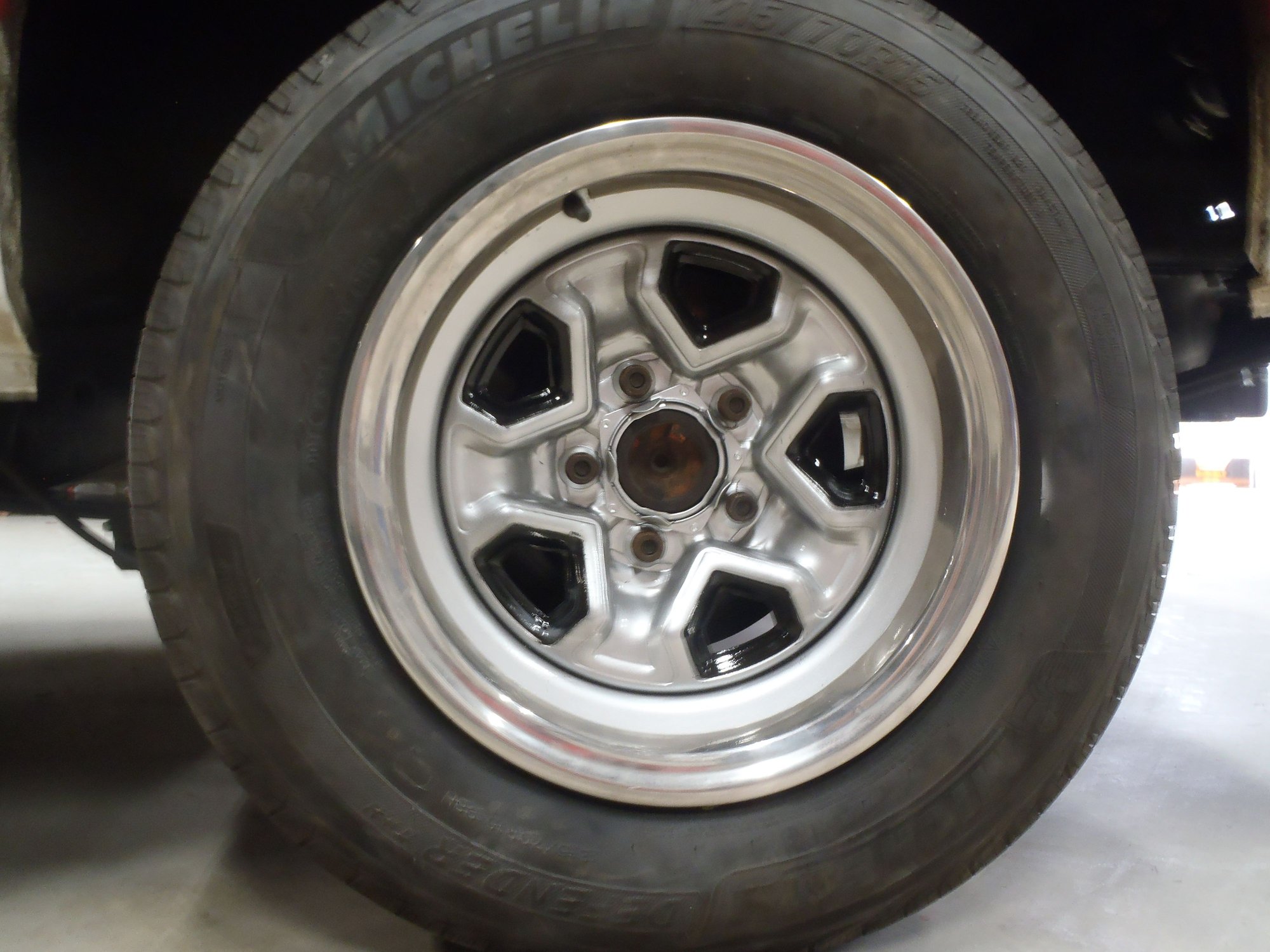

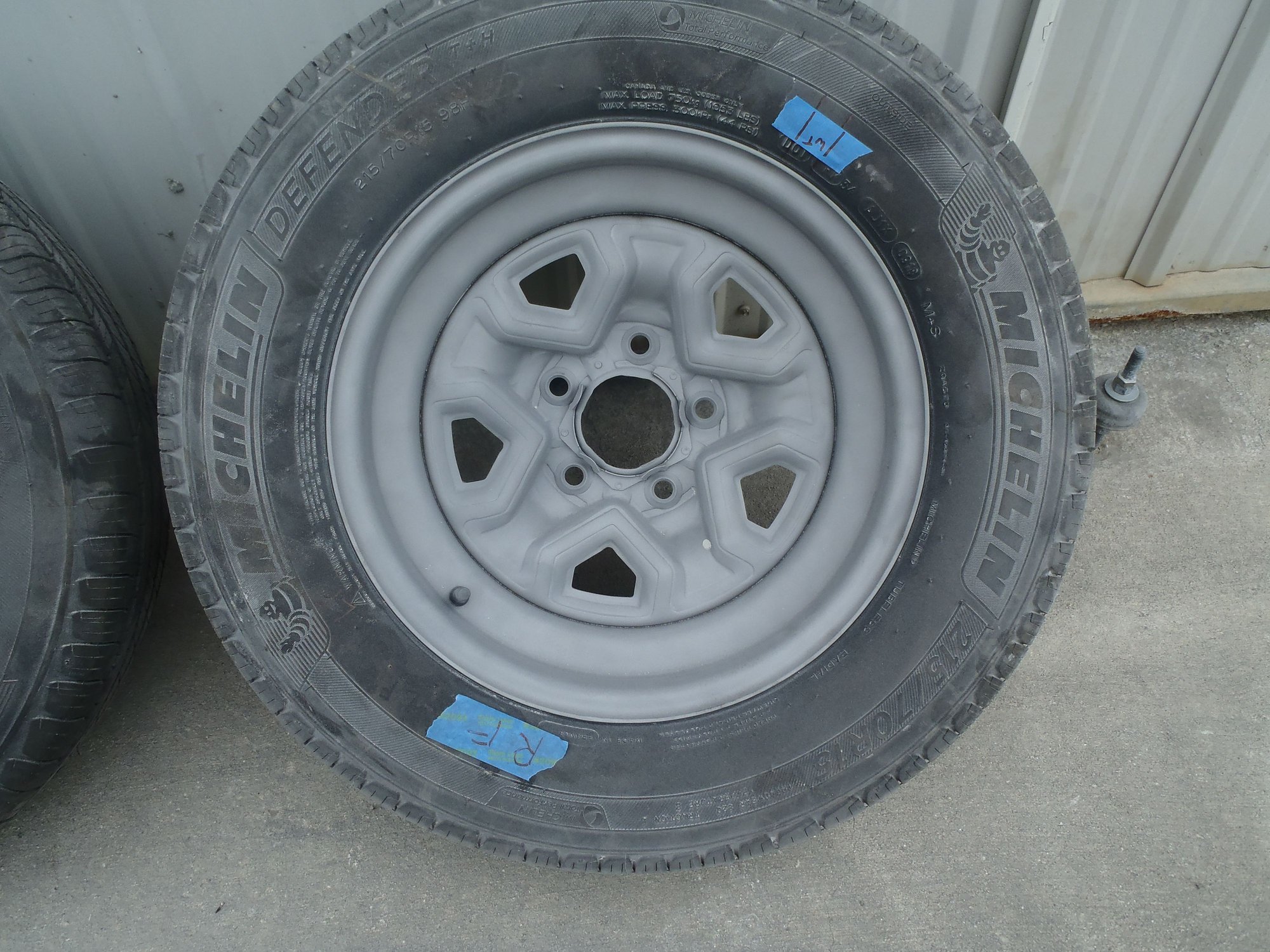

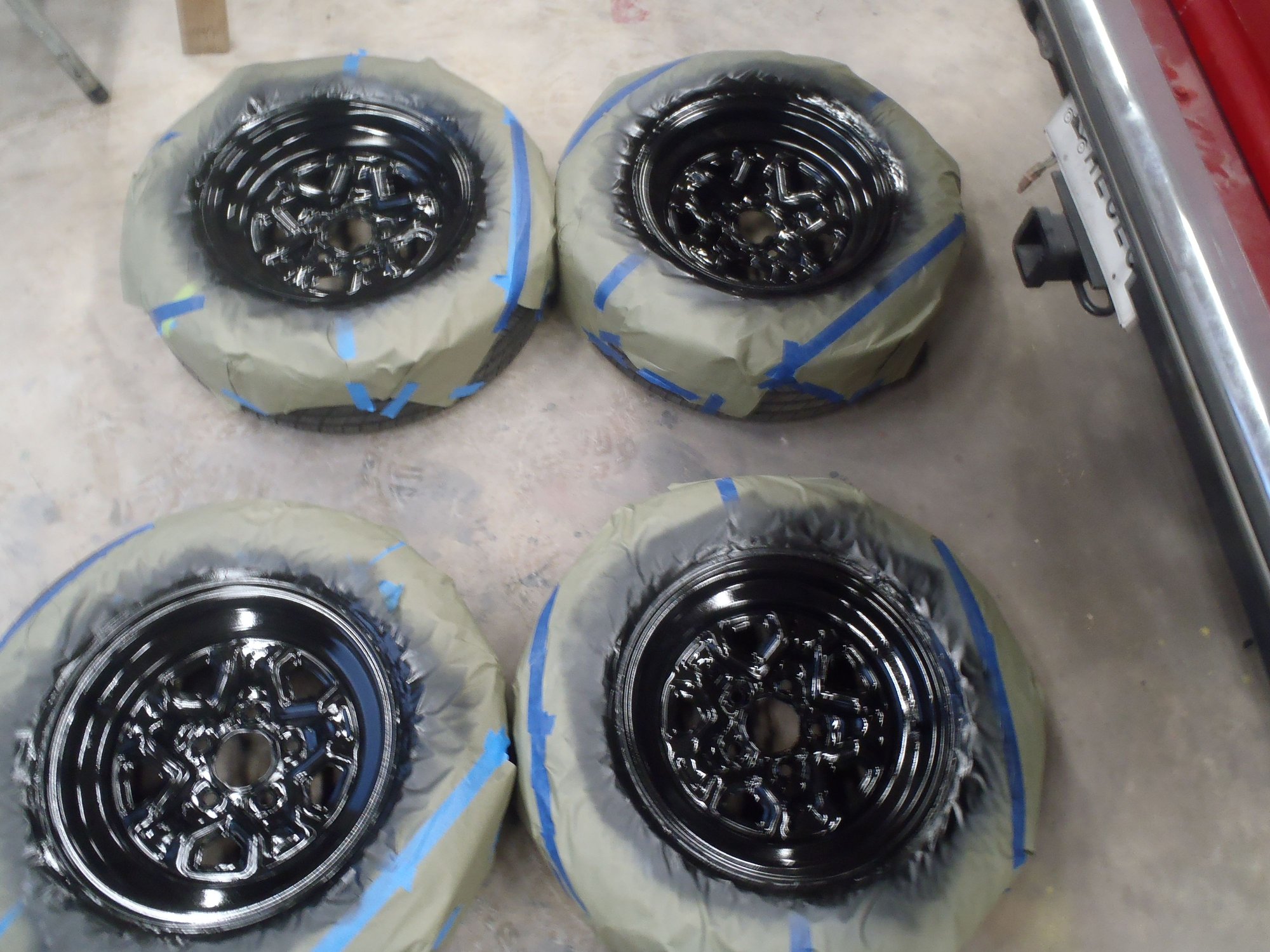

I refinished the wheels on my 89 S15 Jimmy. 1. Blasted to bare metal, 2. Coated with Epoxy Primer, 3. Painted wheels black. 3. Taped off the cutouts and painted wheels silver. 4 Clear coated with gloss clear coat.
Original Wheel condition.

Epoxy primer applied.
Painted wheels with black enamel.
Wheels painted silver, clear coated and re-installed on the Jimmy.

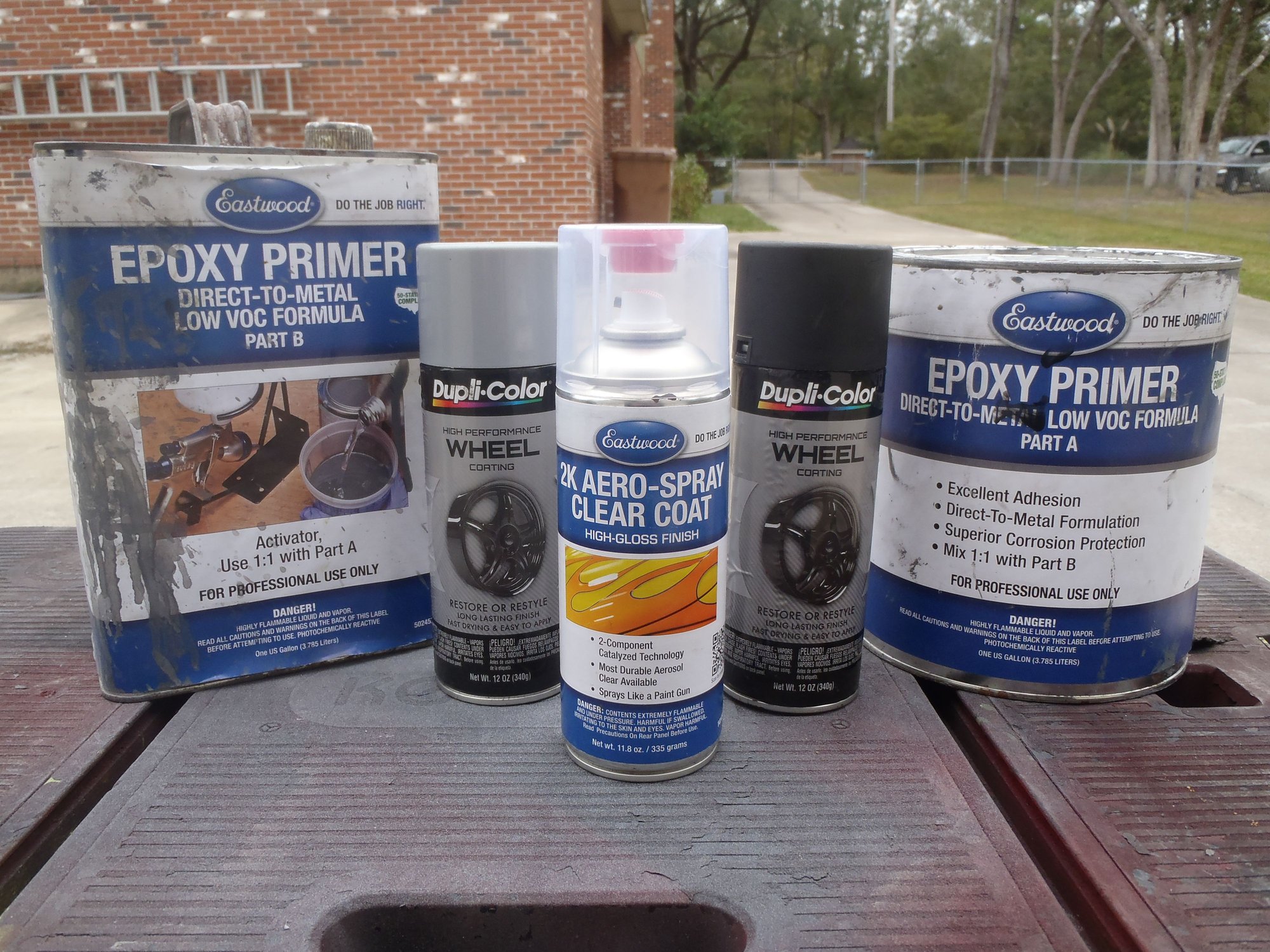

Products used to coat the wheel.
