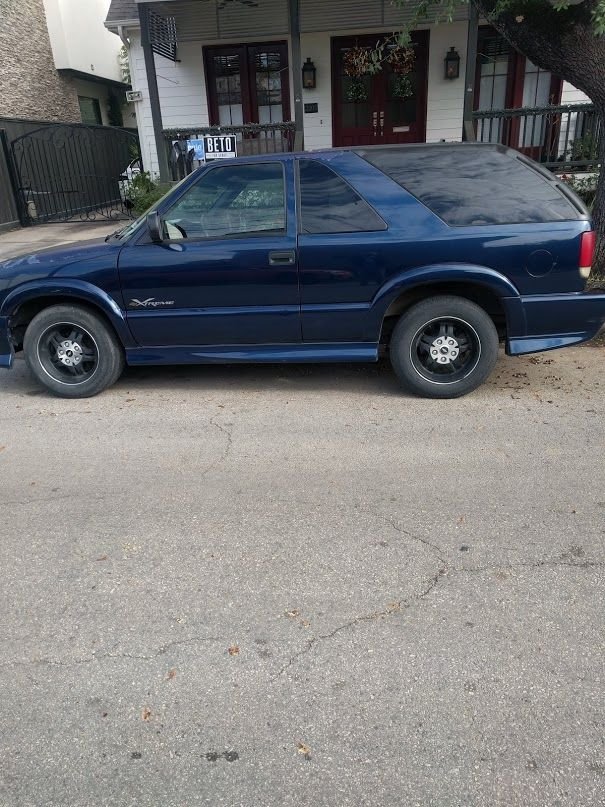

So the larger tires means less jump off the line but it will stay in 1st gear longer (i have a/t)? And the top end will be 7% higher?
The speedo will be off but otherwise there will be no harm to the truck?

GPS app might be a good solution for me too. In which case I could forget about getting someth9ng with only a small speedometer error, I could go with a much bigger tire, like 30.5"
Now, I have a visual dislike for the big gap above the tire. Now the tire is 27", if I go with a 30", how much will that gap close, if any?

Going from a 27 to a 30 is three inches, so the radius will increase by 1.5". So that's how much the gap will close up

So those sizes, 27" and 30" would be the nominal diameter of those tires with the radii being half that. If you go from 27" to 30" tires, the gap will decrease by about 1.5".
Here is a useful link for comparing all sorts of tire sizes: https://tiresize.com/calculator/
For starters, you if you compare the stock 2wd tires, 235/70R15, to 30/9.5R15 you'll discover that the 235/70R15s have a diameter of about 28.0". Of course this does not allow for the compression at the bottom of the tire where it contacts the road. For those two sizes, there is about a 7% error in the speedometer (the speedometer would under-report the speed when using the larger tires).
