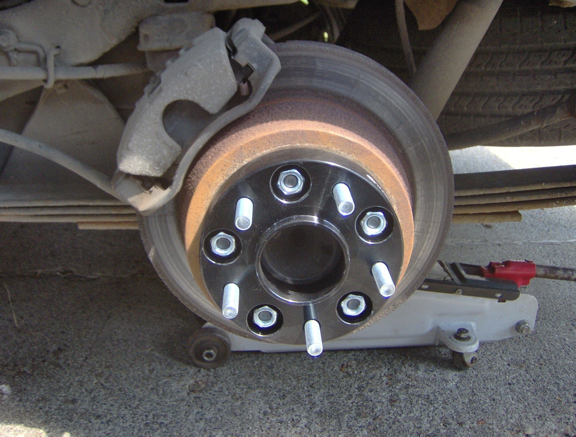

Originally Posted by nomoresubies
OK so if I understand you correctly the rear wheels need 1" spacers to equal the tracking of the front tires. Yes?
And any info on the hub diameter?
I installed 1.25" spacers that were hub-centric. I used 1.25" because I did not want to have to cut down the original lug bolts and I got hub-centric so that they would be additionally supported a bit by the lip on the axle and guide the wheel into place. There might be other reasons too for the hub-centric but I cannot think of them off the top of my head.
These are the ones I installed: https://www.ebay.com/itm/2-Hub-Centr....c10#vi-ilComp
Be sure to double check the fitment though!
