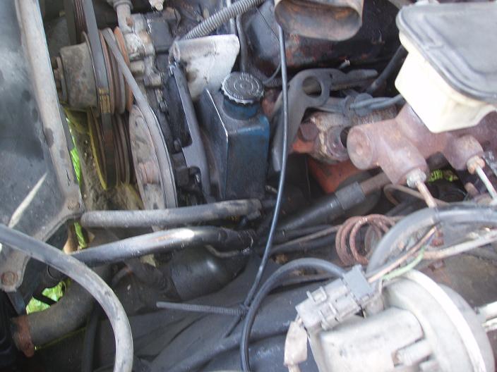

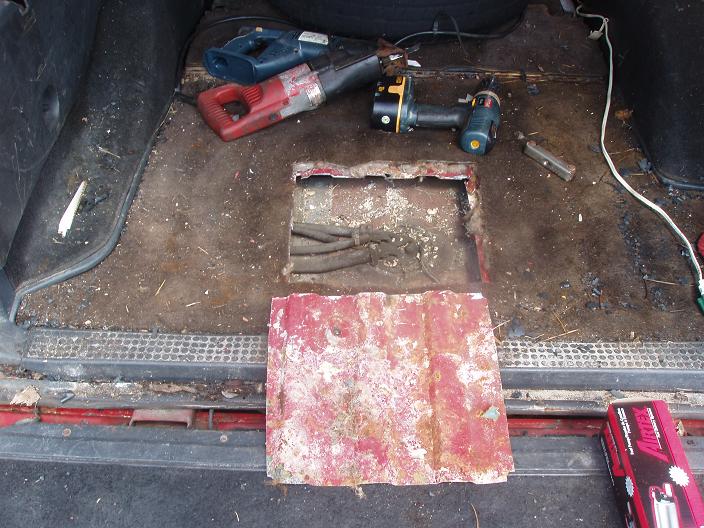

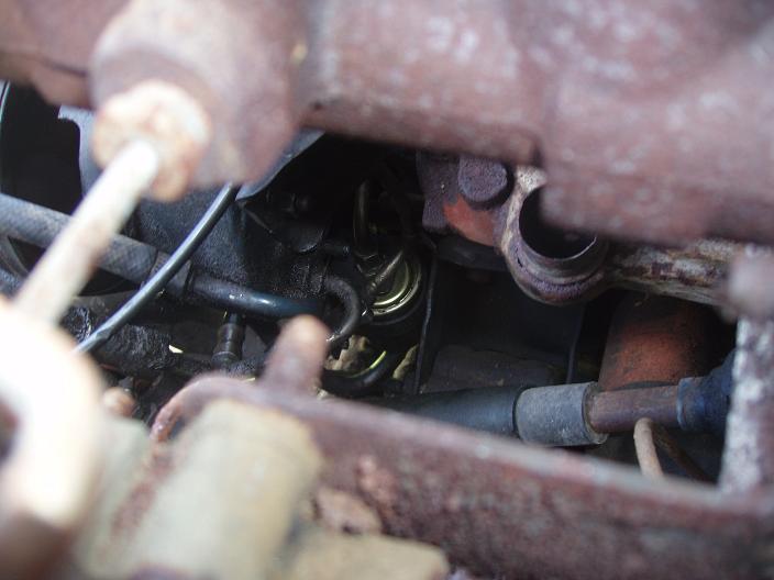

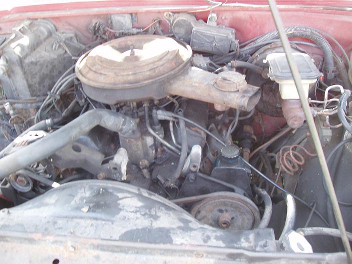

Well, guys i bought a new fuel filter and began my attem pt to install it after work at 4pm. (BTW Ive worked on Cummins for over 15 yrs and have had chevy small blocks since I was a kid) But this little endaevor wasnt pleasent. I was thinking i could simply drop the filter and have it done in 10 minutes. But NOOOO. First After removing the grimy filthy power steering pump, i began the chore of removing the 8mm bolt that holds the inline fuel filter in place while being devoured by sand gnats. But im not complaining. I get the filter out, and I can easily blow air through it. So I know its not clogged. Now I do a test, and apply 12vdc to the little pigtail next to the fuel pump relay, and i can hear the fuel pump running in the tank, but no fuel is coming out of the fuel line- at all. At this point, i take out a razor knife and cut a hole in the fabric in the back over the fuel pump location, because tommorrow, Im going to saw a big hole in the back of it to acess the pump. There no way in hell im dropping the fuel tank, and if it fails again, I will have a big hole to access the problem area. I install the fuel filter and notice the fuel supply line is steel on on end and rubber fuel line on the other, so this way GM can gouge you for that "special fuel line" at the dealer, if your fuel hose ever ruptures. The return line is the same way. After installin the filter, i begin th mundane chore of tightening the 8mm bolt that holds in the fuel filter, and is purposely pointing towards the rear of the car, to ensure the task is slow and ardous. I then install the power steering pump, just 3 bolts and tighten the bolts and belt. One part I ddint mention earlier is when i used a pair of channel locks and an axe to remove the AC compressor and hoses. it was in the way, anyway. Its at this point im reminded of why i drive a toyota. I opened the hood to my toyota and grabbed the fuel filter and and removed both clamps with a pair of pliers and removed it in less than 10 seconds, without getting any grease on me. Then for ****s and giggles, i held my breath, and reinstalled the filter on my toyota, then shut the hood, and started it, and then exhaled. I craked the top on a busch beer and thought about how i was going to saw open the rear of the blazer to create an acces panel- that should have been put there by the engineers at GM. Taking something simple, and making it hard, a sad fact with american cars nowdays. Tomorrow the fuel pump will go down, and the blaz4er will be moving boats around the yard again. Im starting to understand why the previous owner sold this thing to me for $400 cash. Its got 1 tire that goes flat after about 8 hours, and everyone says i should repair it, but no, its my anti theft system. after using it in the yard, the tire goes flat by the end of the day, and it ensure none of the neighborhood punks will take it for a joy ride. Then i would have to buy another 4x4 for abuseing in the boat yard. they tried to stel it once, and ripped out the stupid alarm system, but it would run for them, lol. I also really love how the fuse panel is hidden way up iside the drivers side firewall behind the brakepedal area, really difficult to access. everything seems difficult on this thing, compared to other vehicle Ive owned.

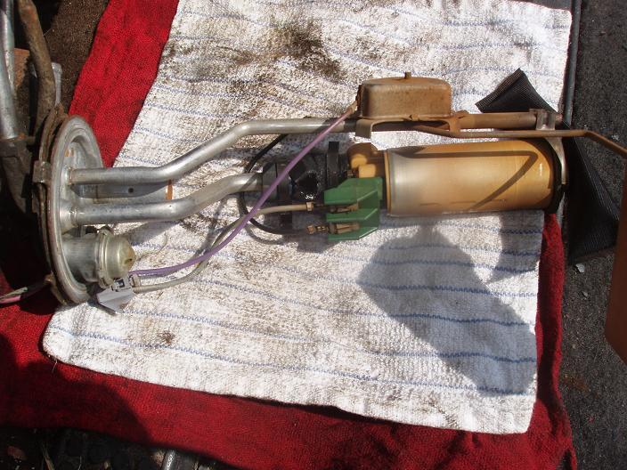

So I get up early, mark the corners and cut myself an acess panel. I remove the grit and debris from the pump/float assembly and remove the sealing ring to gain acess to the pump. Note picture 12--- the pump is working fine, but the short rubber connection tube has a hole blown through it. At first I think of replacing the pump with the new one i bought, but noticed several variations witht he replacement pump, so I just changed the rubber tube and clamps and reintalled the pump/float assembly. I remember when i was young, I had a 69 Chevelle, and when the feul pump failed, I just had to remove 2 small bolts from the front of the engine to replace the pump. None of this crazyness with an electric motor running inside of your gas tank. Aftr finishing, i turned the key on, waited about 30 secondes for the pump to prime the fuel system and it started on the first try. The inside of the gas tank looked great, the lines are all clear, and the filter was ok. so for everyones notes, if you hear the pump running inthe tank, and youre getting no fuel, at all- its probably the little crappy rubber jumper tube has ruptured- possibly due to the alcohol they are adding to the fuel we use nowdays. Thanks for your inputs, guys!

The picture with the brake master cylinder, shows the location of the fuel filter, hidden benath the power steering pump, and right next to the exhaust manifold. Really diffult to acess.
