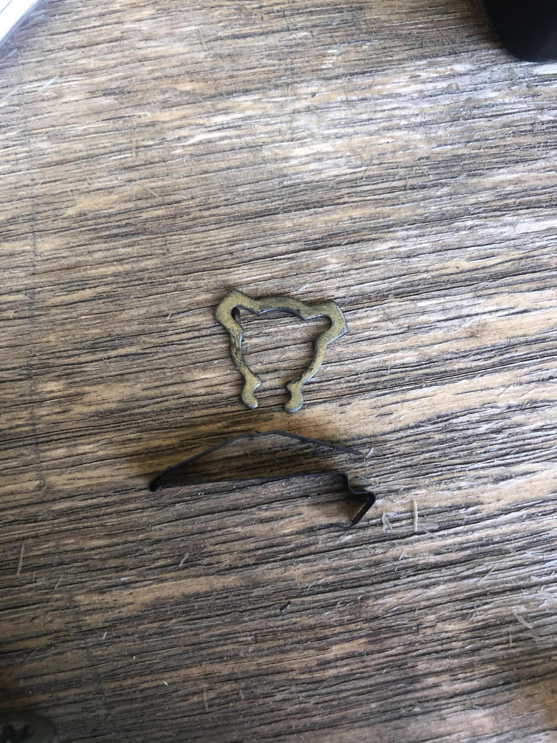

Hey all. I found a number of very helpful threads on this subject, and there's a 3 part youtube video someone made a while back going through the whole disassembly on a first generation tilt wheel. Upon removing mine (to fix a very loose tilt wheel assembly), two pieces fell out at one point and I wasn't able to catch or figure out where they came from. I've found an exploded view and can't seem to find the part I'm looking for as they aren't very good resolution and these are small detailed parts. I'll post those links at the bottom as a reference for anyone doing this job in the future, but here is a picture of the two pieces I can't identify.

Can anybody help me identify where these go? Thank you!

Whoever owned this car before me took the column apart at one point and didn't put it back together correctly. The retaining ring wasn't even installed on the shaft.
I found this image
showing that the triangle shaped piece is the retainer for the main nut. The dude that disassembled this may have just shoved it in there somewhere because it fell out when I was far past that point lol.
I just need to figure out what the small clip is.

Found it! It goes on the bottom of the small white plastic piece with two copper contacts, the key warning buzzer, to hold it in place. Here’s a pic for reference, it must’ve fallen off and just been dangling around until it fell out.
