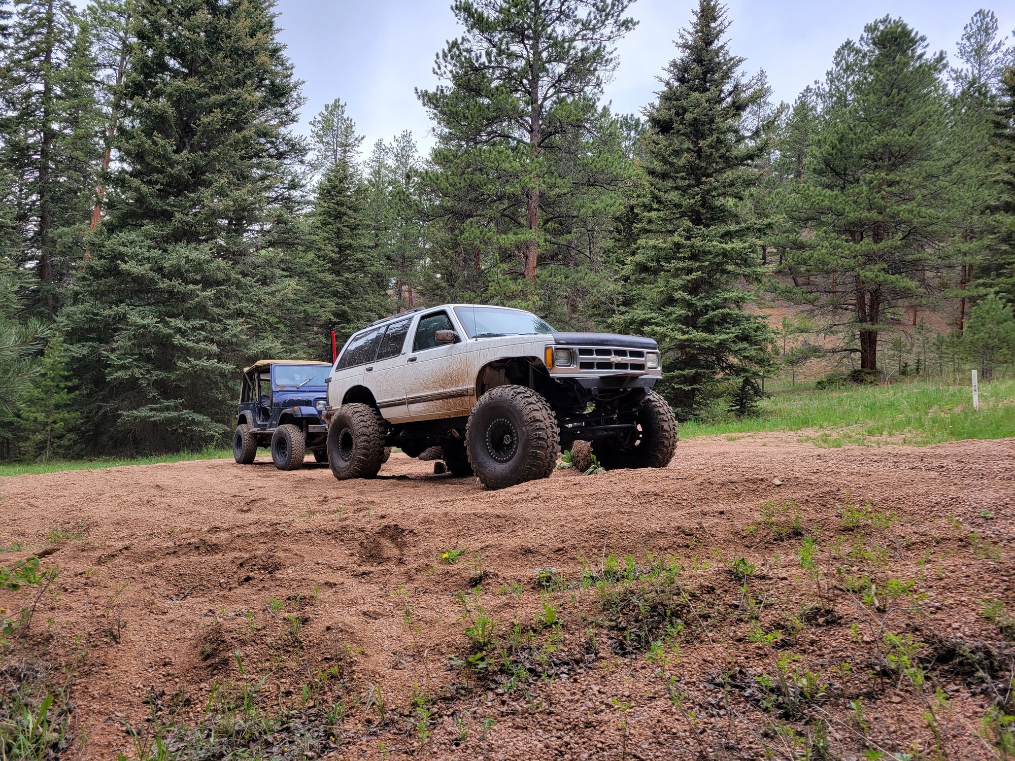

And if you wanted any details on the build, here they are
D44 front, Ford 3/4 ton 8 lug
GM Corporate 10.5" 14 bolt full float rear, narrowed 5" to match front
5.38:1 gears, Detroit lockers front and rear
TH350 trans, dual RF1A Toyota transfer case
1350 U Joints
Triangulated 4 link coil suspension in rear
3 link suspension with Ballistic Fab 16" travel air shocks in front
39.5x13.5 Super Swamper IROK bias ply tires on 15" DIY beadlock wheels

I don't really have any suggestions for you, but it's cool to see another rock crawler here. Nice rig.
