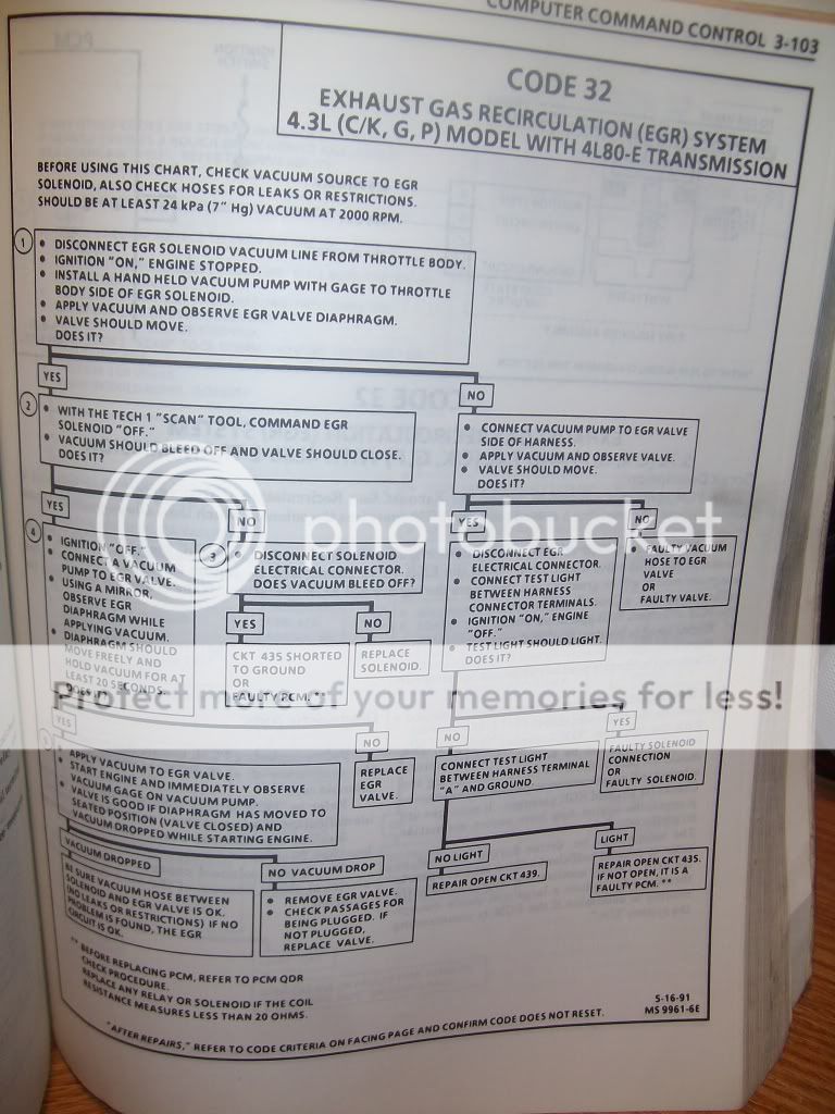

sorry for the bad picture
but this is how to diagnose code 32
I took this picture off my gm service manual
Edit: Oppsy let us know what engine you have and the year
I think i gave ya the wrong page

Thanks for replying to my problem post. The S-10 Blazer is a 1992 4.3 engine code "W" which is the Vortec with MPI. The vehicle is a 2-door 4x4 that has been in the family since new. It has 126K miles on it. It currently is my "snow plow" and it has a Meyer 6 1/2' blade. I also have a 1997 LT that I purchased new.
I'm not sure that there is a plastic line from the EGR. I will look this morning again, but all I saw was the electrical connection plug. The plastic line may be for 4.3's with a carburetor. I could have missed it though, the EGR is behind the belt tensioner and lots of other hardware and wiring.
A diagnostic schematic for the code "W" engine would be real helpful Gio.
