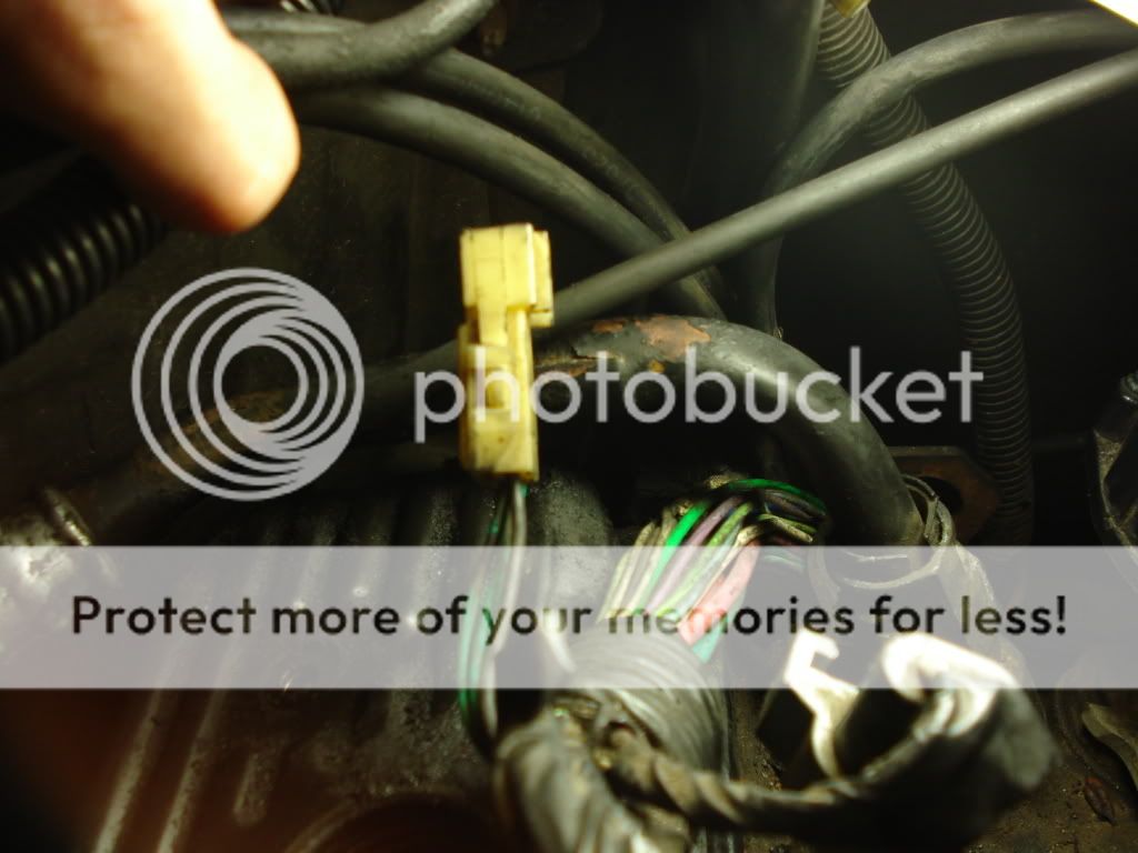

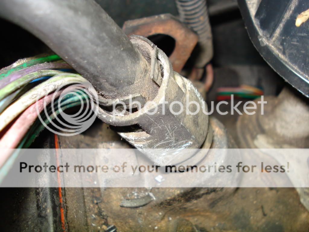

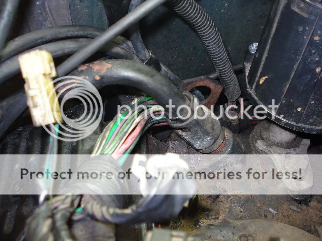

Ok so heres the update we got the driver side done in little under an hour the passanger side has us stumped.
How do you get the heater hose connector off the top of the intake manifold that is the onlything that is blocking the darn thing from coming out if we had 3/8th of an inch we would clear just cant get that damn dig out the way. Any advice on how to get that connector out the intake.
Thanks bobby

Any way you could snap a pic of what you are having troubles with? Its been a long time since I've worked on an early 90's 4.3L

Oh yeah, I remember those damn things!! Try soaking it with some WD40 or equivalent and letting it sit for a bit. Sometimes the plastic seizes inside the aluminum lower housing. If you can rotate it side to side even a bit, it'll allow the WD40 to work in faster and release it more quickly.

Well I got the gasket replaced once that piece was removed it was a sinch to do.The only bad this is i had to remove the idle contorlor and when i was putting it back in it snaped on the last on the last thread making it almost impossible to get out but hitting a flat head in to it and just keep chisseling away got it out. Now just waiting for the rtv to dry so then we can put oil and the dye in it and see if its still leaking
