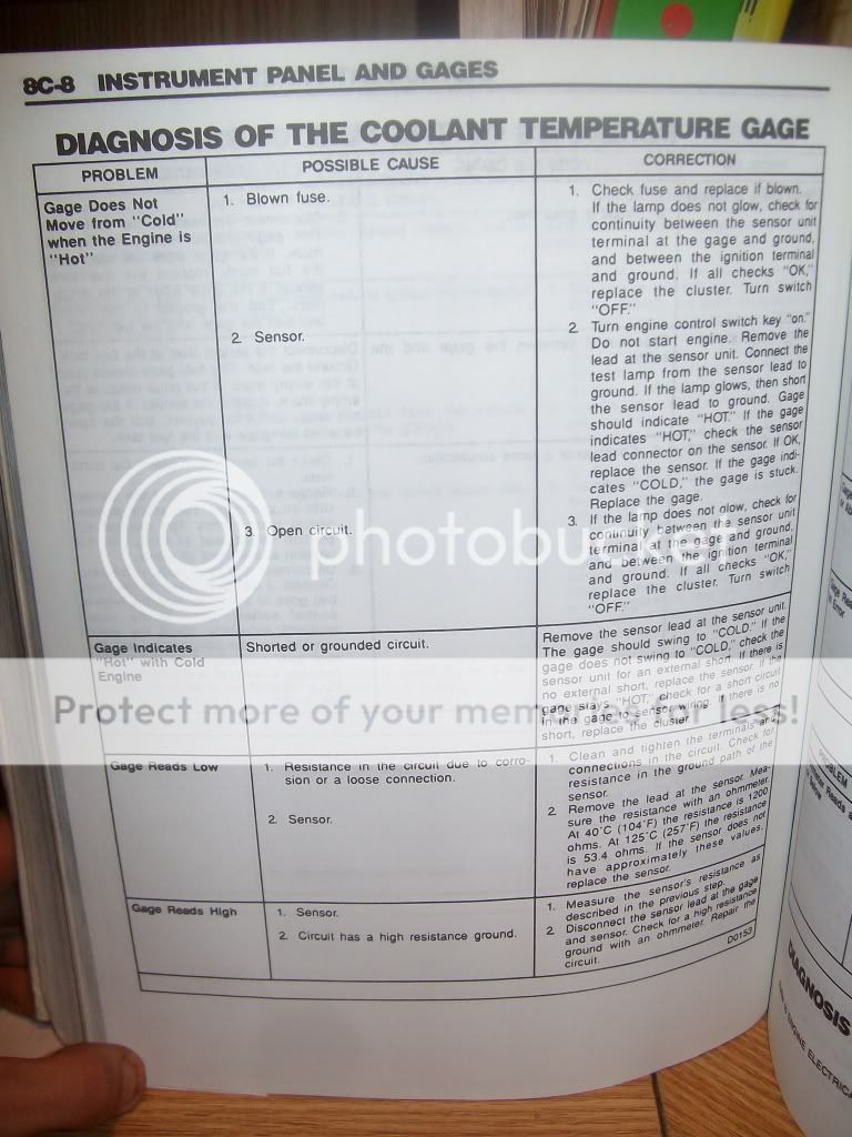

Edit: If you have a vortec and the 8th digit of your vins W
this sensor location map is right if you dont have this motor ill get you the right sensor map
And here is the diagnosis for the temp gauge
