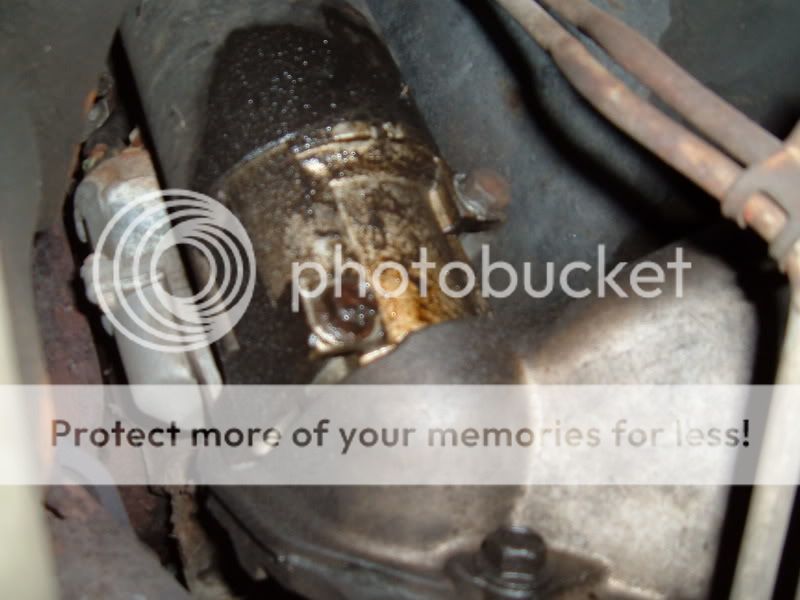

http://i141.photobucket.com/albums/r...7/HOUSE011.jpg[IMG][/IMG] 92 s-10 blazer 4.3 its on the passenger side anyone know what this is.

isn't that ur stater motor! the leak might be above it from maybe the back of the valve cover where they are notorious to leak and is hard to see.

It does look like a leak down from above the starter.
So I would be checking these:
Valve covers (not hard to change out due to 3 top mounted bolts that hold it down)
Remote Oil Filter (check to ensure that the seal on that is good)
Distributor seal (this one is kind of hard to get at, but if you take a rag/towl and dab it behind the engine under the distrib you can see if you have fresh oil there. If so then you need to pull your distrib and replace the rubber O-ring that seals that)
Try these and hopefully you can relax some. Keep posting a pic and it can help in getting a reply that will be more direct to the issue. And remember you only live once, try to enjoy life not stress it.
