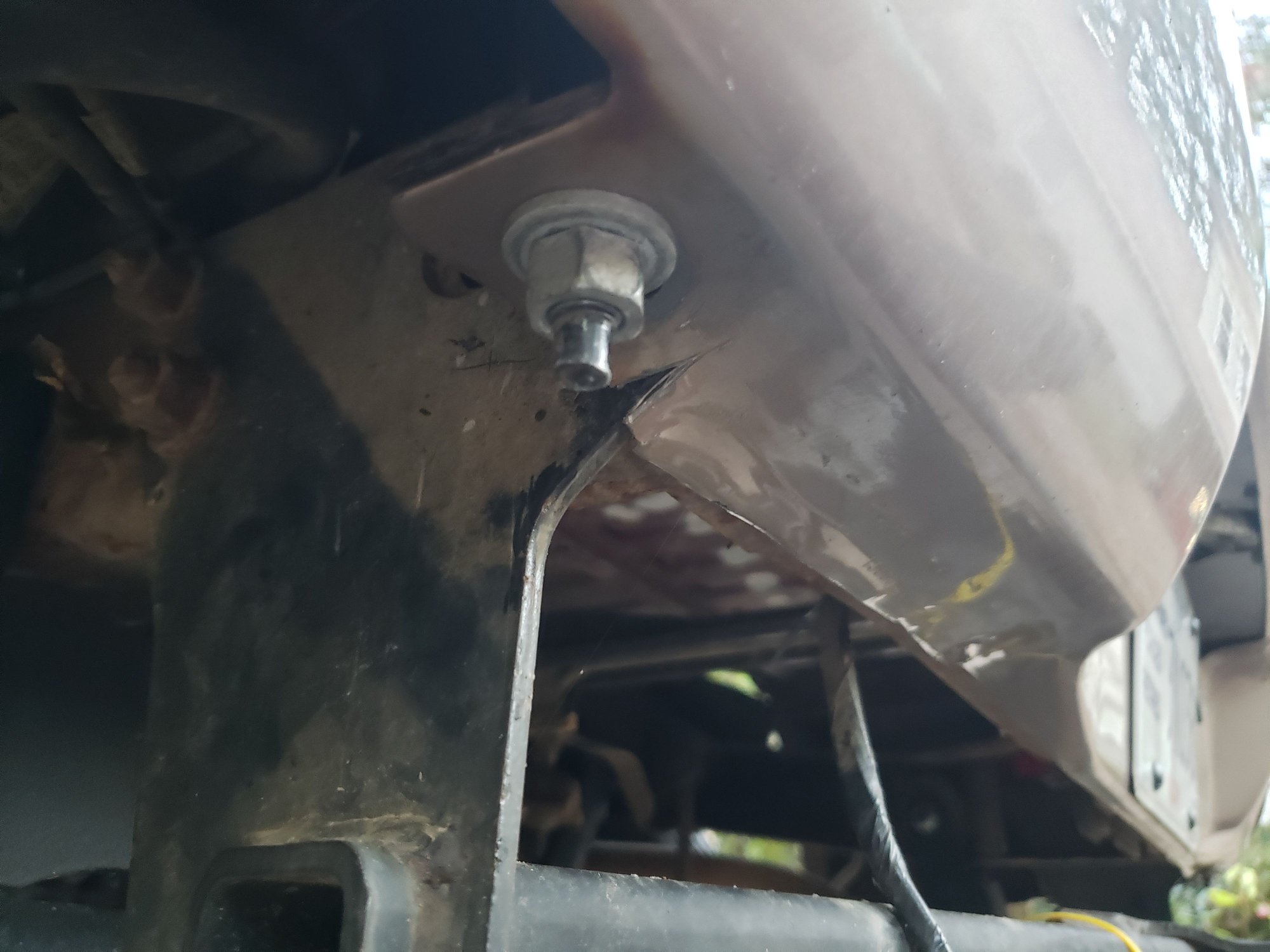

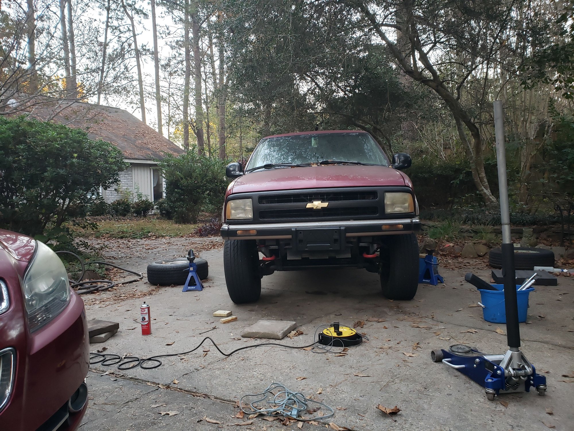

Here's pictures of where I clipped and flexed rather than cut the bumper, as well as the front. CV Angles look good I'm going for an alignment after I put my bilsteins in tomorrow.
