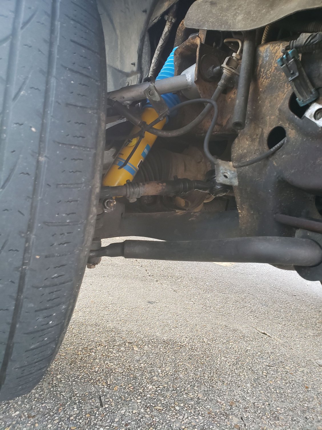

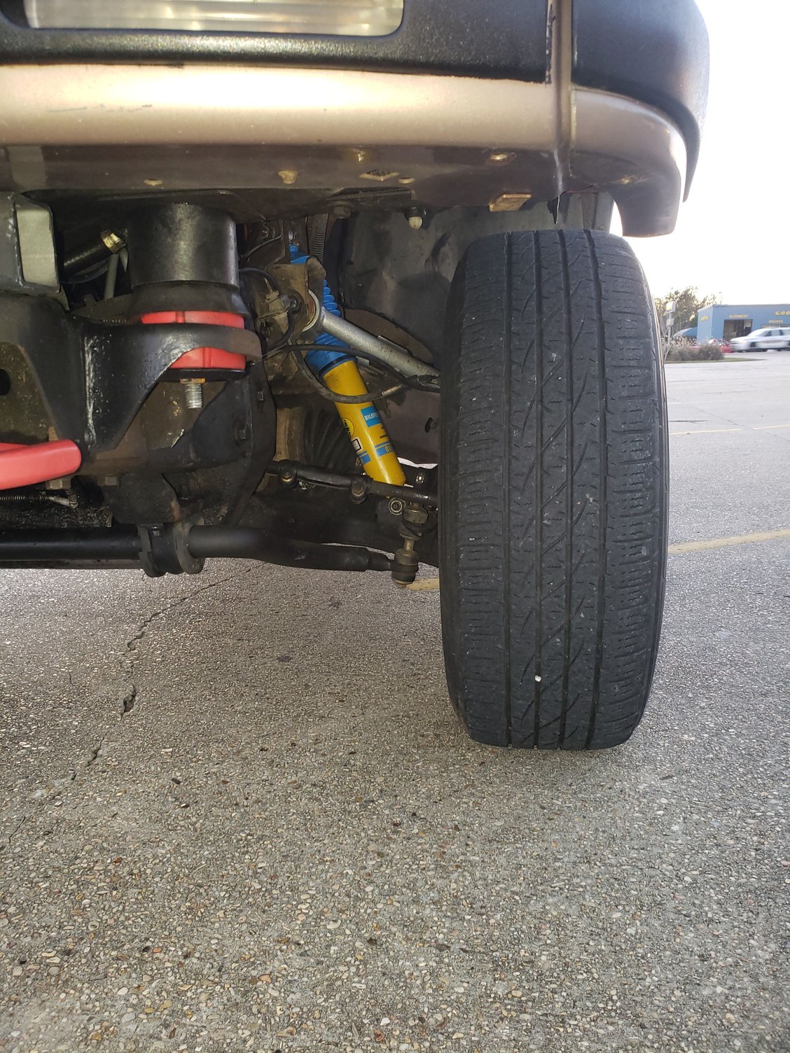

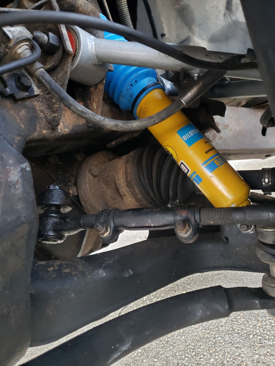

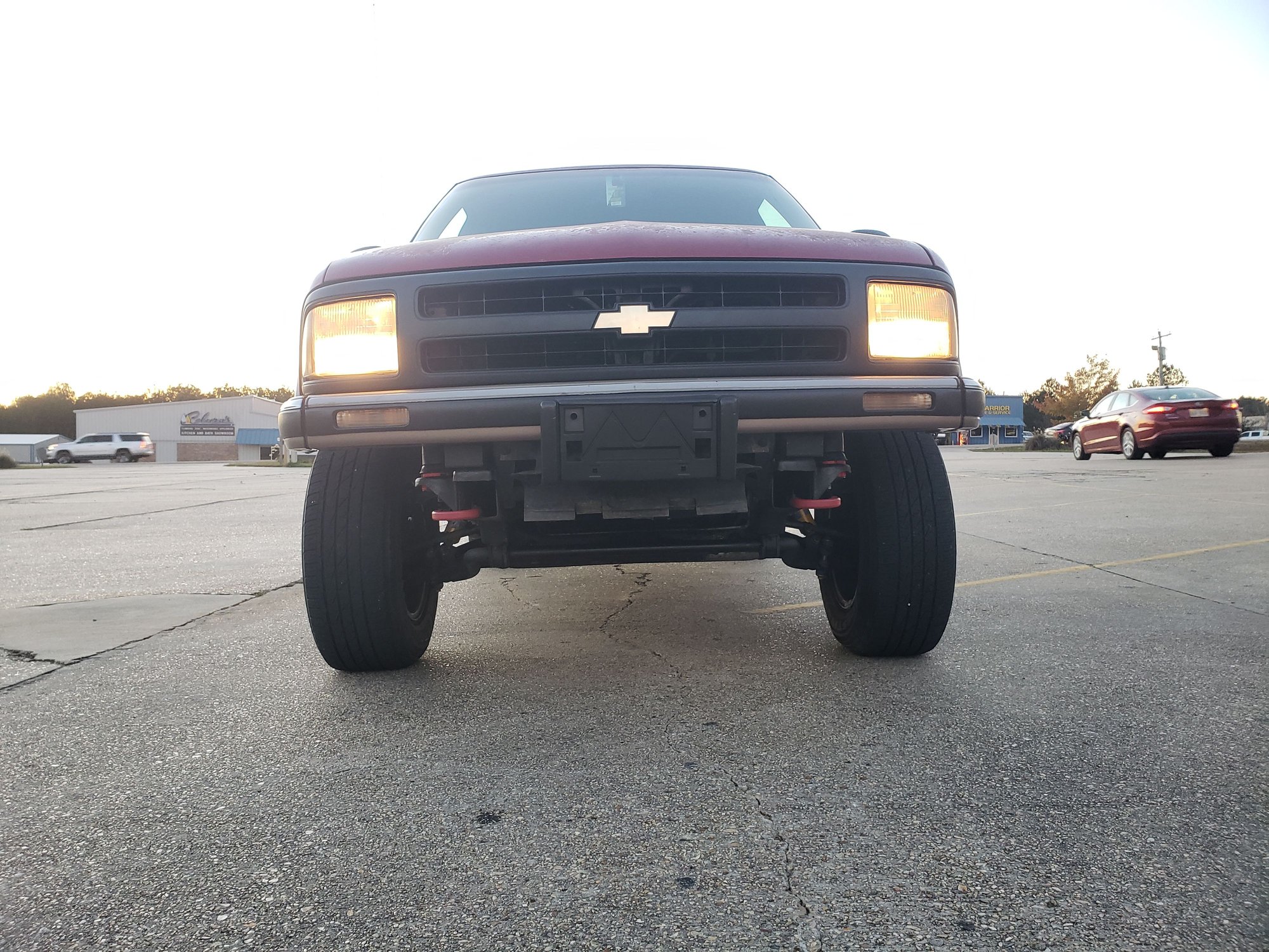

Here's some pictures of it now, the only thing that I've done besides the lift was a new steering gear but I had to change the shaft seals so it should be centered perfectly.
Old Nov 30, 2020 | 05:06 PM
  #32
Turn your steering wheel all the way both ways, count the turns. It looks like the steering box isn't centered...
it appears to be the same, here's the video
Lock to lock https://imgur.com/a/RxNCqtW
Old Nov 30, 2020 | 05:26 PM
  #34
So I noticed when you went to center, and then turned left, there was an extra 90° turn almost.
I'm suspecting the box is off center.
But I'm a driveway mechanic lol, and its only my best guess... wondering if anyone else will chime in...
