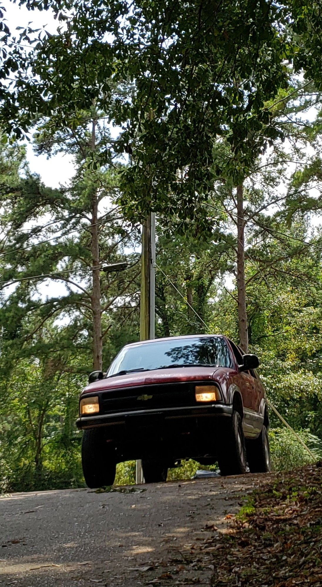

Hey everyone!! Just an update. Like I said I had it stock and they aligned it. Months have passed since then but I couldn't help notice the front of my car was higher than the rear. Today I had the urge to throw the longer shackles on and give it another go. So I spent the two or three hours and finally got them on. Assuming that I didn't touch the torsion keys since it was a little taller in the front I assume its still in alignment. Here's a picture of it! What size tires do you guys recommend??? It's got a 2inch shackle and torsion lift and a 2inch PA body lift and no front lower valence.

In theory, lifting the back will affect the caster in front. But the difference in your case is so minimal that it won't make any difference. And caster doesn't affect tire wear, so it matters even less.
If you don't want the tires to rub on rough terrain, I would go with 30x9.50 but you might be able to get away with 31x10.50 if you do some minor trimming.

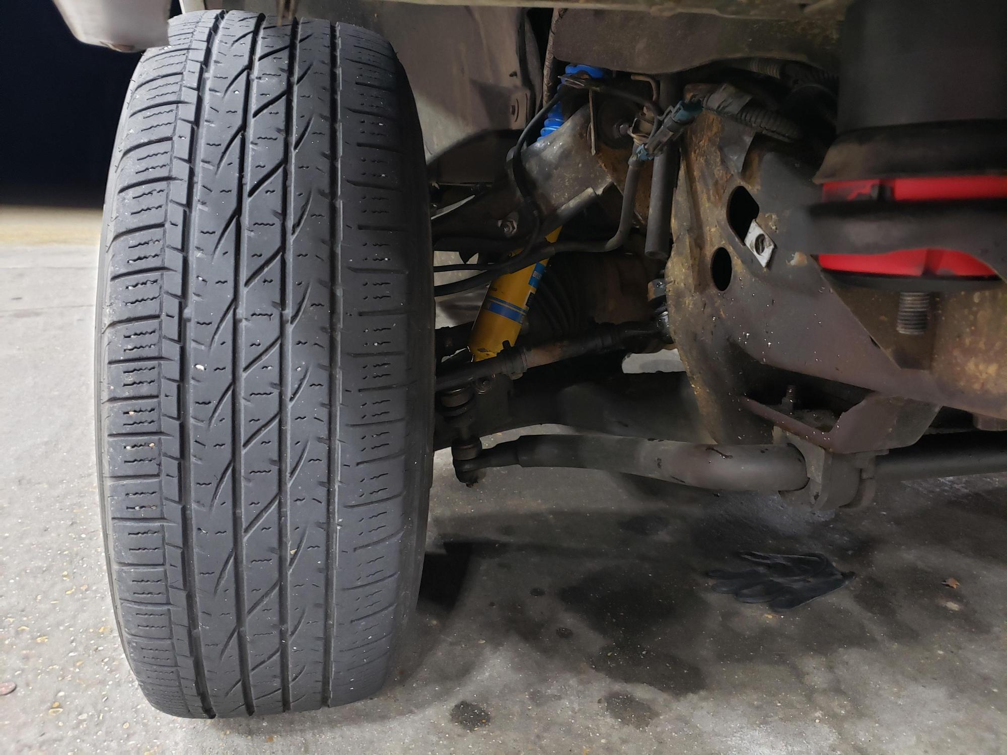

Here's my stock front space without the valence. Whats the size of the 31s you think I'd be looking for? The 31x10.50R15s?
