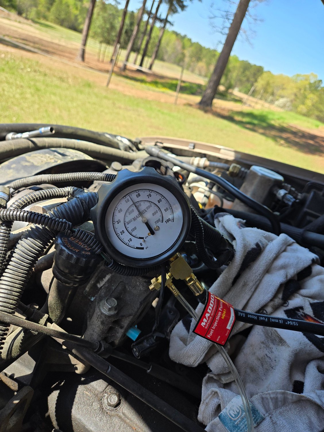

Since I went back to my maddox pressure tester I guess it could be off a couple psi. This pic is the 53ish psi after she sat for 2hours. Doesn't always go up. I'm leaning towards the leaky injector theory. As when I crank it. Then things changes a bit and bleeds down.from 52 to 49-50 after an hour

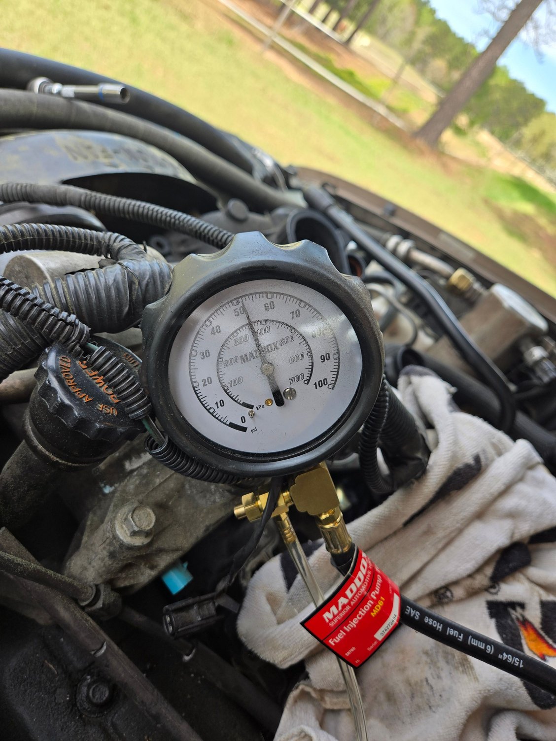

the other pic shows immediately after 3sec pump off. 52psi. Which seems to be a constant now.
