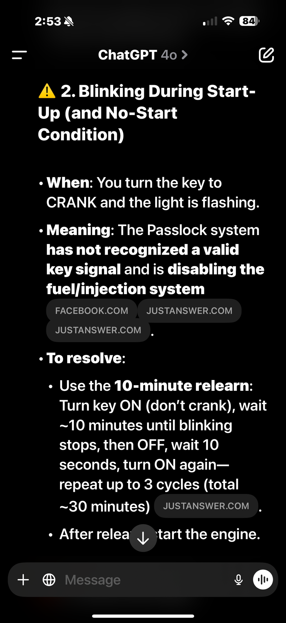

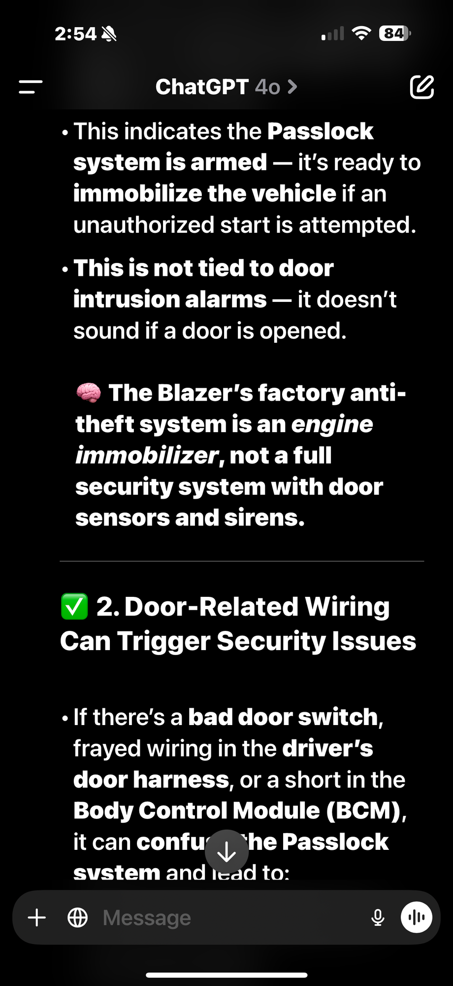

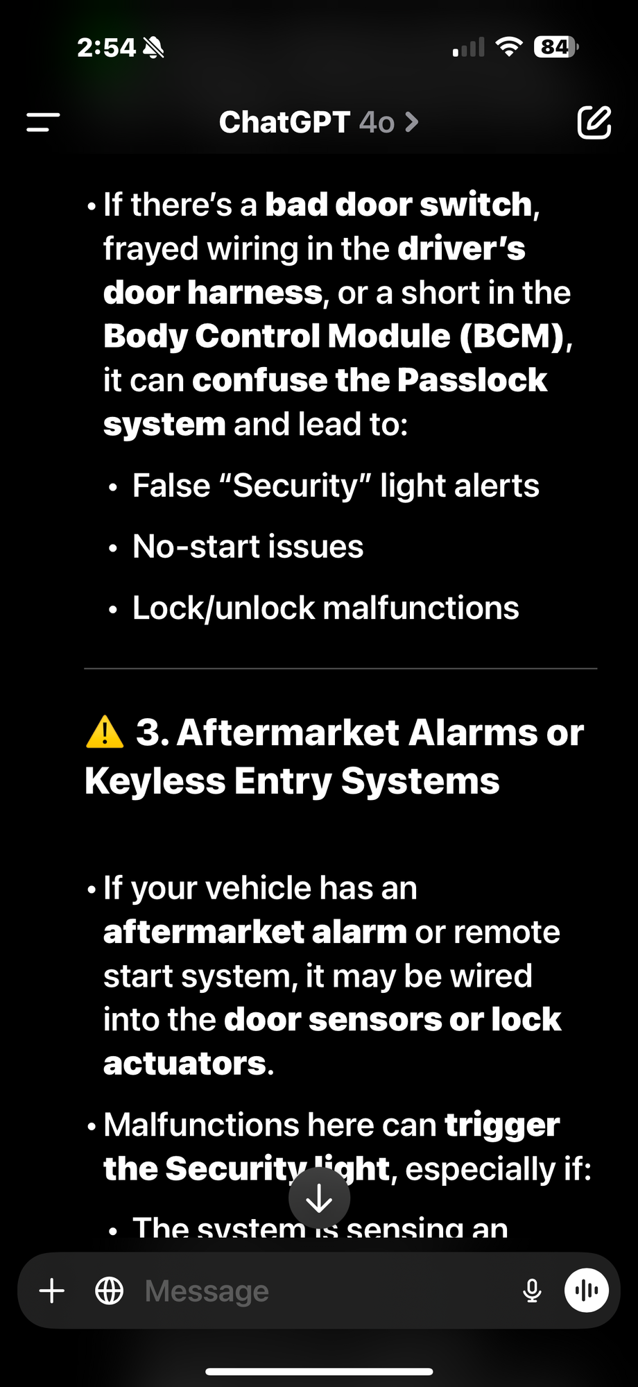

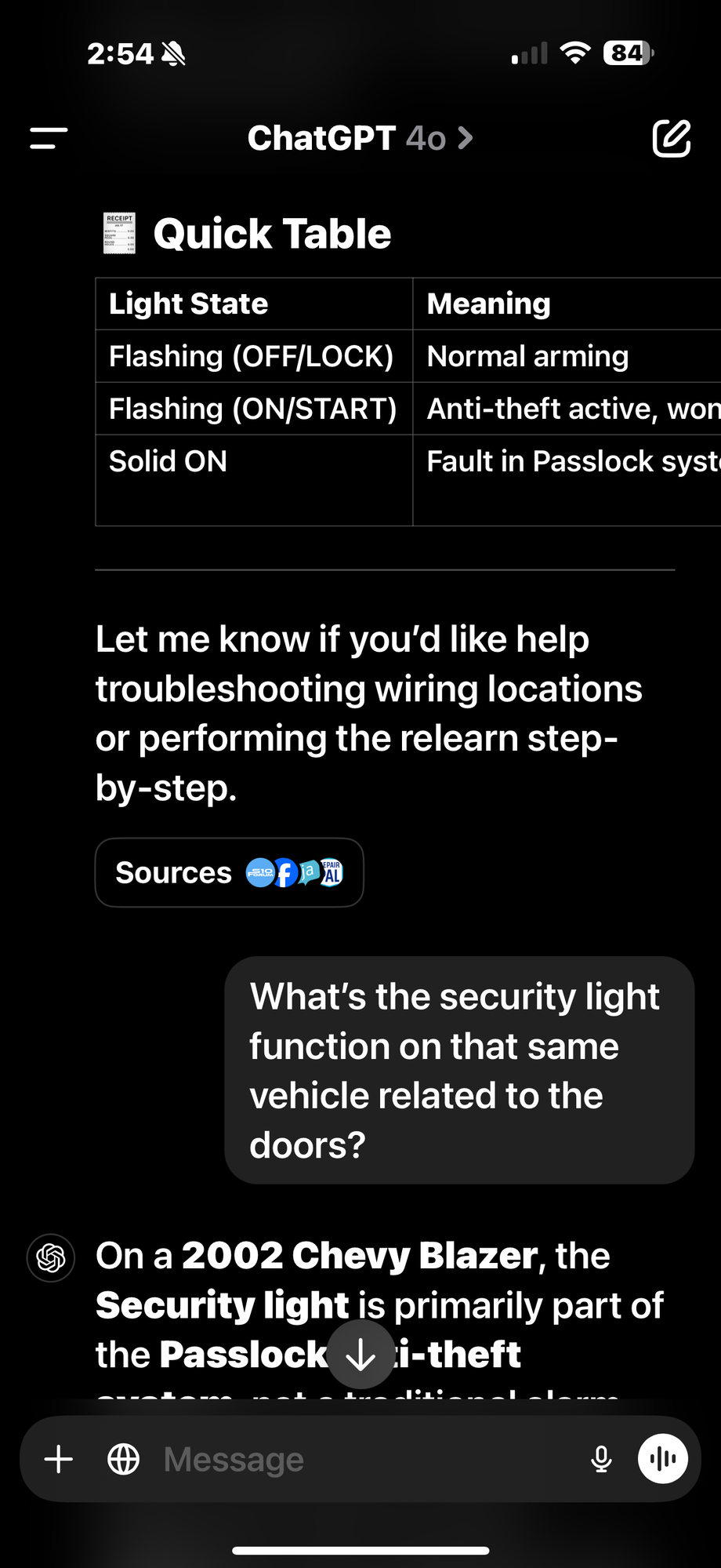

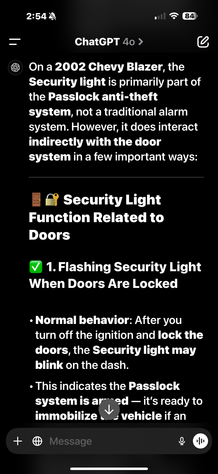

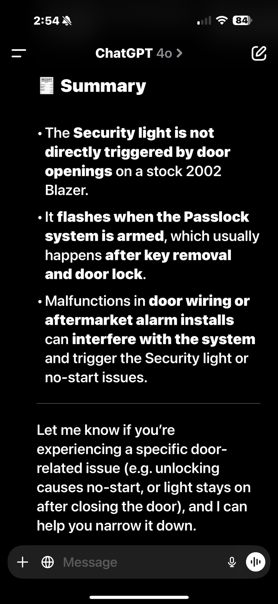

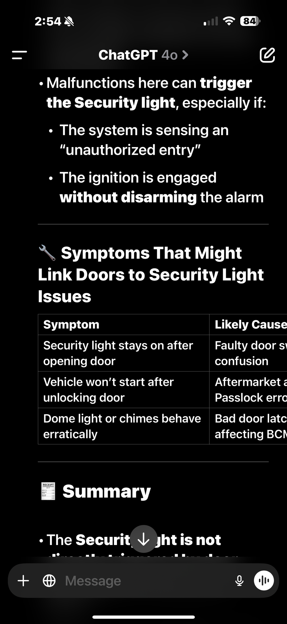

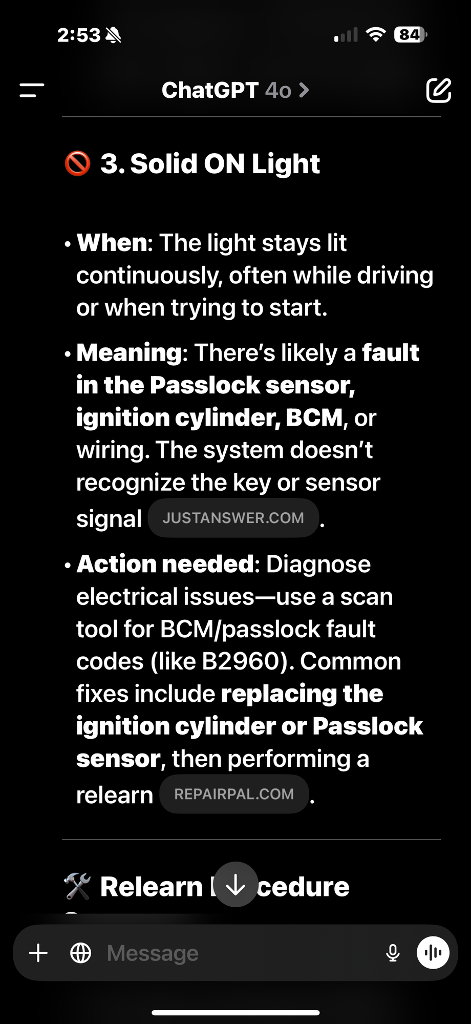

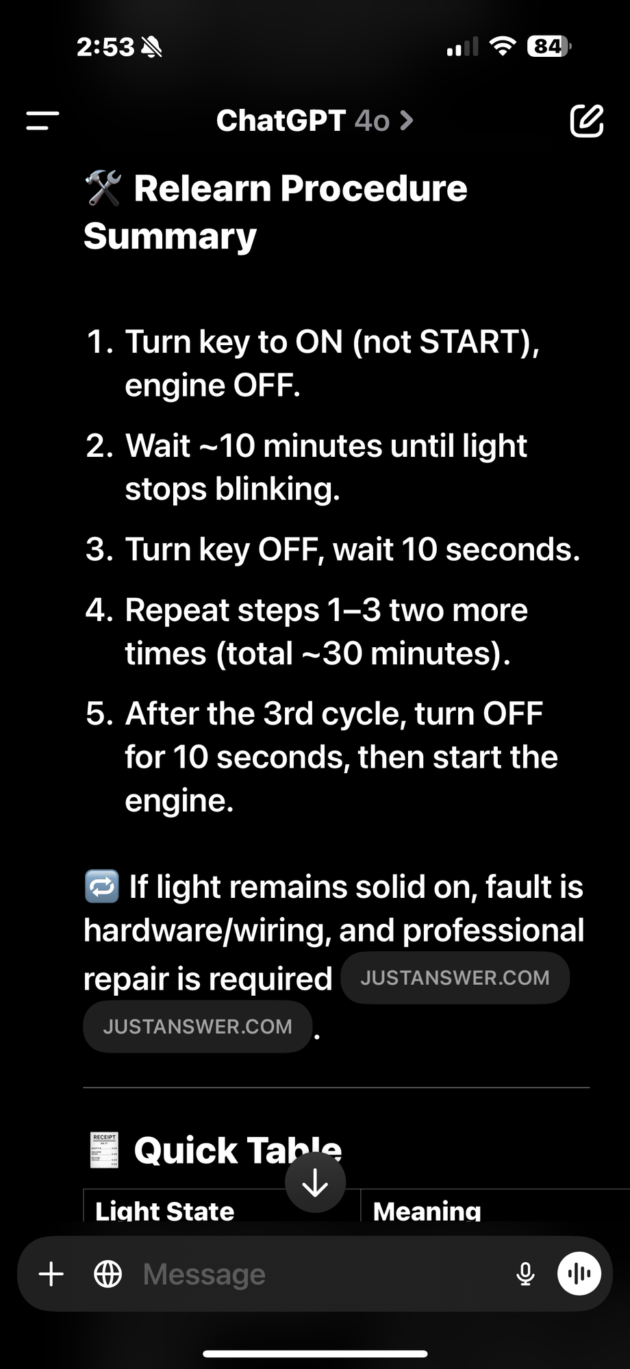

I have never fully researched all the different behaviors of the security light in our trucks and I don’t have time to go through the manual right now so I did a ChatGPT search and here is what I came up with in case it’s helpful for . These may be out of order.:
George
Old Jun 30, 2025 | 02:17 PM
  #40
GeorgeLG's Avatar
Posts: 4,642
From: Florida
I reordered these screen shots because they were a mess
George
