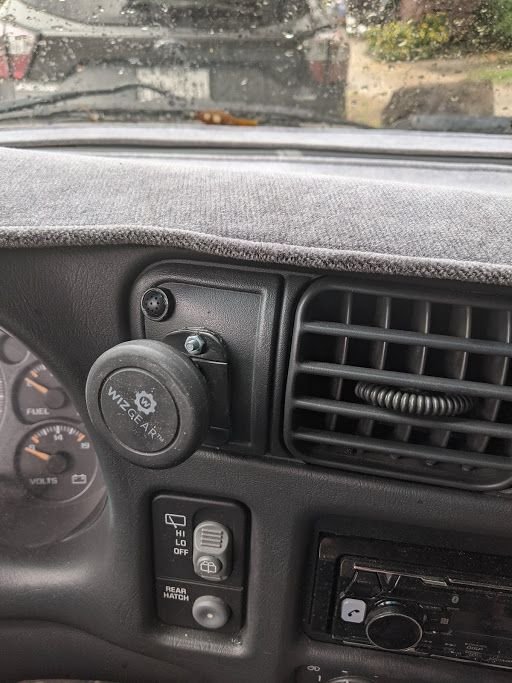

Put a decent radio in there. You can drill out the piece of pop-out plastic for a microphone and a magnetic phone holder.

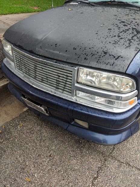

Replace those dim headlights. Dump the third brake light. Get a cooler looking grill, from ebay. And some door window shades. Maybe install a roof rack with some lights... and how about some underneath the car, too..
Cover the hood with a carbon fiber vinyl wrap, and the roof, too. Do something nice to the wheels, please!
