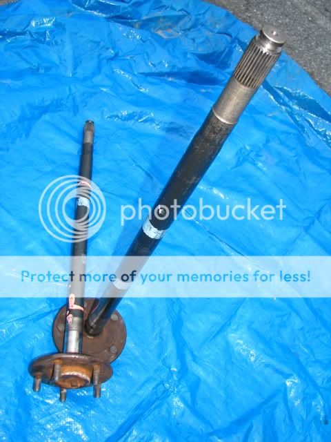

If you have the pinion shaft out, you should be able to slide the axles from the outside in to get to the c-clips.
You can see where the c-clips rest in this picture. Right above the splines where the indent is before the end of the axle shaft:

Thanks TripleBlackBlazer. Mine looks somewhat different, but I am not sure what the clips are on yours. Is it the bronze colored part?

Yes the C-clips are the bronze colored items in tripple black's pic. He gave good advice not to rotate the carrier with the shaft removed. The small gears sometimes have spacers under them and they can be put back in if they fall out but it is no fun.
