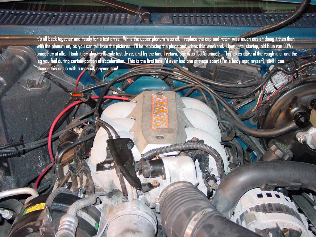

Default My error
Maybe I'm referring to the MAP sensor. This sensor is located at the front of the air intake. This vehicle does not have the original motor so I'm needing to know what to look for to distinguish the difference from a 95 and 96 vortec.

I started with a check of the distributor. After removing the cap I cleaned the rotor button and all points inside with some emery cloth. I noticed the wires on the distributor for the spark advance module were pinched when the rotor cap was last put on. I thought they would be ok so tucked them in proper and reinstalled the cap. Then I pulled all the plugs and adjusted the gap. I had to adjust them due to wear of approx. .020 That solved my misfire and she is running fine.
