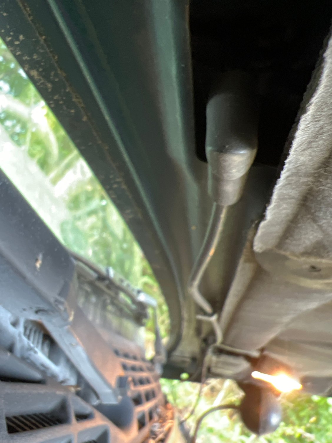

I have been working on the restoration of my 1995 Chevy Blazer 4x4 LT for over a year! I am nearing completion and surprisingly don't have hardly any parts left over! LOL I do however have a ground wire that goes to my hood lamp and I'm not sure how the washer line routes behind the brand new hood blanket I installed.
Can anyone help tell me where the hood lamp ground wire goes? ... And if the windshield washer line goes behind the first grommet or the first two grommets of the hood blanket? Pictures would be helpful. Thanks all and keep on Blazing!
Windshield washer line. Does it go behind the installed grommet? Or the second grommet to be installed?
This ground wire comes from the hood lamp. But I don't know where is grounds. Does it ground behind the hood lamp? ... Or somewhere in the engine compartment?

It grounds on one of the hood lamp 7 mm bolts..

on one of the 7mm bolts that holds the under hood light on....

Yes, ground goes to the right mounting bolt for the light itself
Ground for under hood lamp
And as far as the washer fluid lines they’re mounted with clips along the bottom of the hood, at the cowl side, and just “T”ed up to the nozzle…
Aimed more towards driver side, washer tube is held by clamps down the back most part of the hood, driver side is “T”-ed up to the nozzle, and passenger side is 90-ed
The end on the pass, side 90°-ing up to the nozzle.
hope this helps, figured the pics would be right helpful. GL on the rest of your Resto, can’t wait to see pics..!
Are you doing a all O.E. restoration, an All O.E. #’s Matched Restoration, or have you done any custom modifications to the Blazer..?
