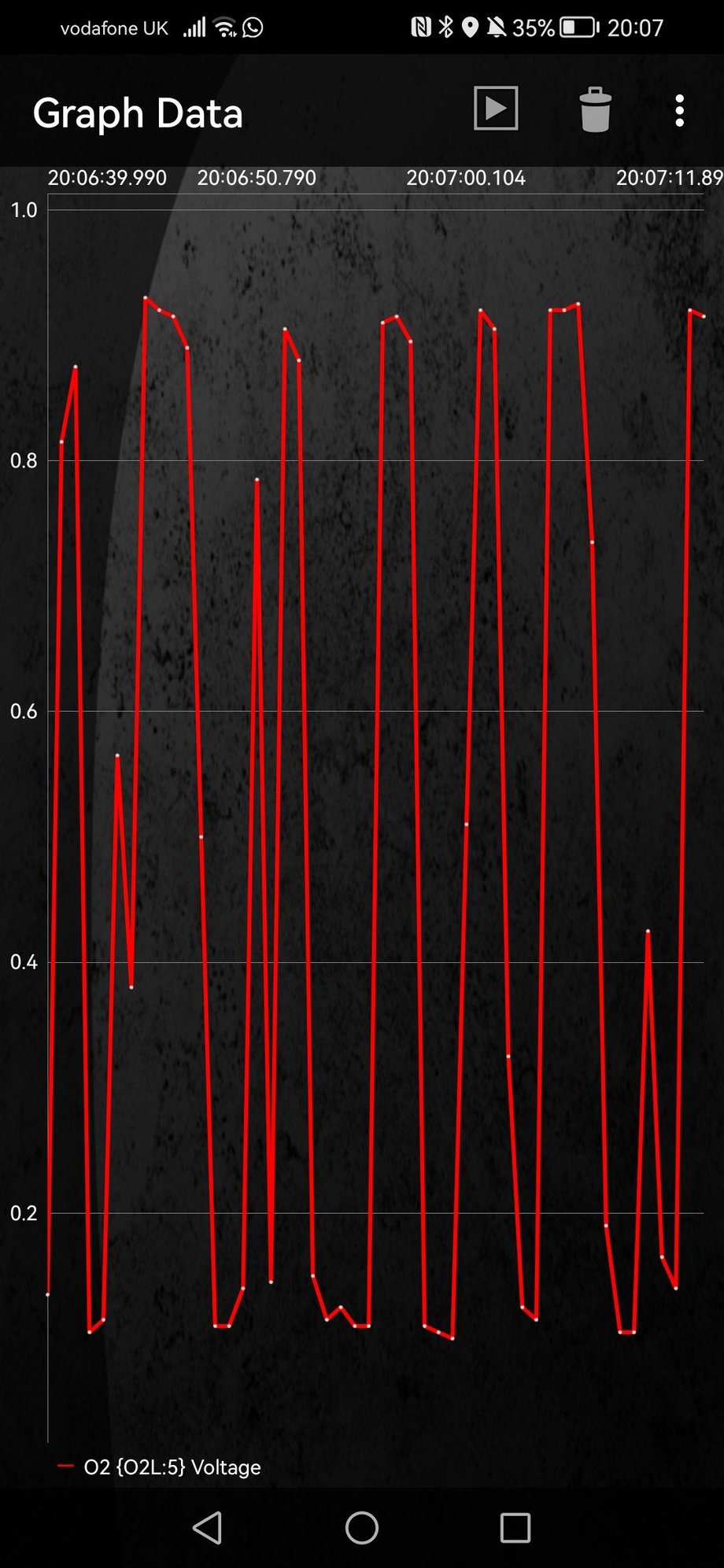

I have attached 3 graphs from o2 sensors
2 look normal but one is below the range you have suggested it should be.
Just to tell you I am in the UK and have a RHD UK supplied Blazer.
I have noticed the sensors are 1, 3 and 5 on the Torque app.
I assume this o2 reading is post cat? And is nirmal
This o2 reading seems in range?
This one is not the normal o2 reading?

There can be confusion on the O2 sensor labeling in some OBDII apps. The formal labels for your 98 are:
  1. Driver upstream B1S1
  2. Pass upstream B2S1
  3. Post cat B1S3 (this is B1S2 for other model years
I am not familiar with your RHD UK supplied Blazer so I don't know if that affects this. Your first graph would be normal for a new post cat (roughly flat line somewhere between 0.45 and 0.7v) but that graph is suspiciously perfect and so it might be the default presented if the sensor mapping is wrong. 0.45v is the bias voltage presented to all sensors by the ECM.
Your second graph is good, thats what a precat sensor should look like
Your third graph if accurate is not normal.
I would want to verify that your sensor mapping/graphing is accurate, Les might be able to help here, he knows more about these apps than I do. We could also verify at the sensors/app with some experiments if needed.

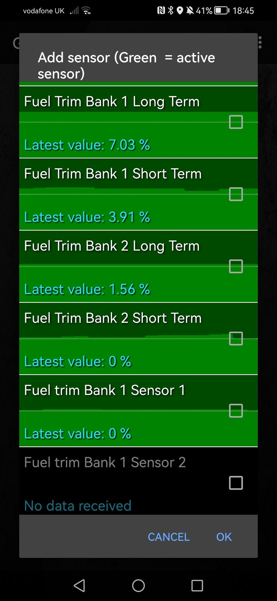

1) An engine running rich can kill O2 sensors so its best to analyze and get to the bottom of the root cause. What are your 4 fuel trims at idle and again at 2500 rpm's?

I will look at fuel trims next

These are a screenshot of the fuel trims
