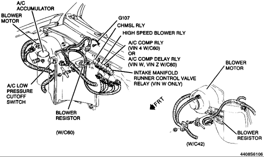

There should be one plug on the blower motor. Mine has a purple wire and a black wire. The black is the ground. I just cut it and spliced in a new ground, mounting it on the firewall.
That is strange that you don't have any relays. There should definitely be relays somewhere... Try following the purple wire going to the blower motor back to where it comes from, that should lead you to the relay.
Attached Thumbnails 98 Bravada No AC/Blower fan help!!!-2009-05-19_092105_lp.gif

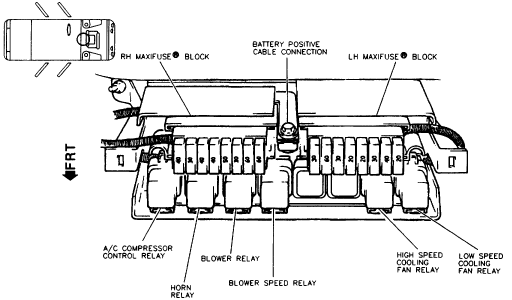

Does this look familiar?
Attached Thumbnails 98 Bravada No AC/Blower fan help!!!-2012-06-19_183041_1.gif

thanks for the quick reply!! My truck has the blower motor resistor/relay next to the blower fan mounted next to it. It has the Automatic Climate control and that resistor is like $180 which I replaced like in the pic with W/C42. But I will try anything right now. Thanks StokedStephen. I will try that tonight if it quits raining.
