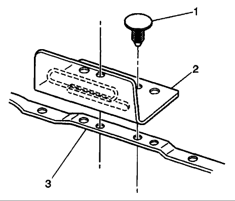

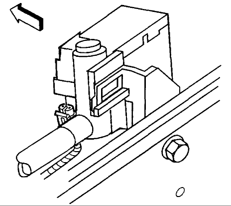

Old Oct 5, 2007 | 06:59 AM
Default RE: 99 dtc po442
Yeah, the aftermarket repair manuals leave a LOT to be desired. Let me see if I can dig up a good illustration for you. On the 4dr it is relatively easy to find, but on the 2dr, the illustrations don't really show its location all that well...
Here ya go:
The first one is the sheild that should be attached to the fuel tank somewhere... The second shows the valve itself.
Hi,kyle,
Ok i'm living in a few minutes to finish some boby work and paint on my truck (getting rid of rust in lower quater panel,rear bumper done last week-end,let me tell you, lot of time but doing great).
Quite generic picture it looks like,it is very closelook,buti will follow your hint, and i'm gonna get under the truck to investigate. I might have to remove the skid plate to surch that valve.I will let you know by the beginning of the week.
