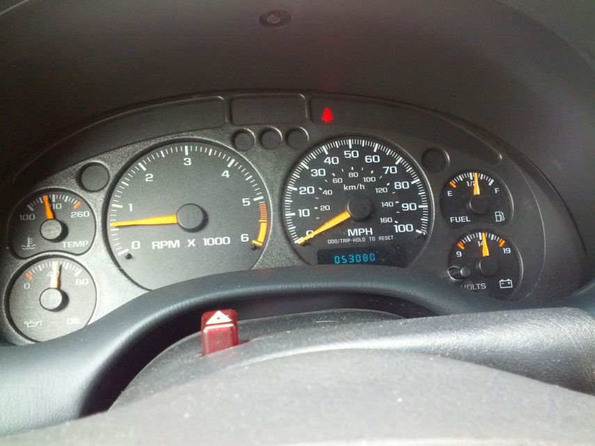

Lanny, I got the unit back from you, installed it and .... Ta da!

You only have 53k miles on your Blazer??..!!!
That's just wrong!
Old Aug 17, 2015 | 10:47 AM
  #46
puttster's Avatar
Joined: Jul 2015
Posts: 708
From: Houston
Lanny, I drove around today, hitting puddles getting the tires wet and then hitting the brakes. ABS is working perfectly. No lights on dash. Everything a GO! Thanks and great job!
As for the 52K miles... The Blazer is my daughter in law's, who commuted about four miles with it. It had been sitting up in her apartment garage for two years since she got a new car. I offered to sell it for her, so the brakes was a fix I wanted to do. I've kind of taken a shine to it though.
