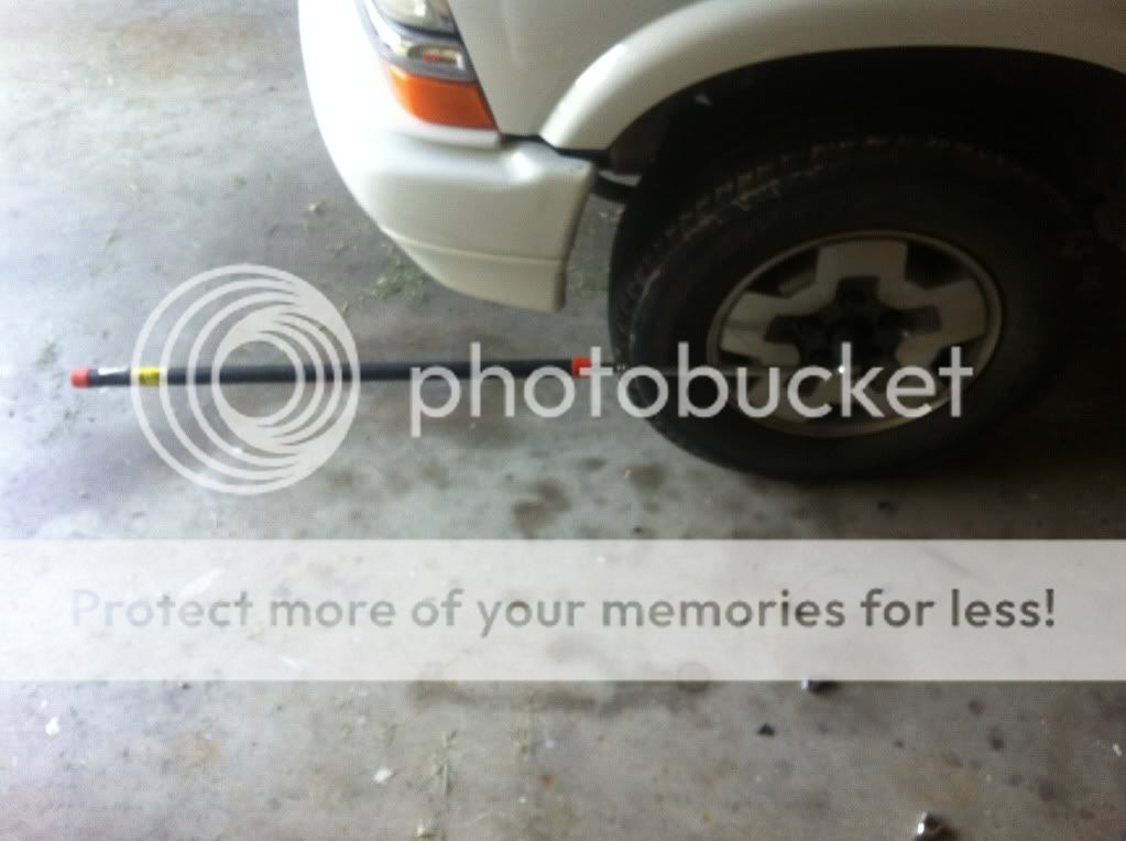

50percentgenius's Avatar
Joined: Jan 2012
Posts: 157
From: Bartlesville, OK
50percentgenius is on a distinguished road
Click on that
That did the trick for sure!
