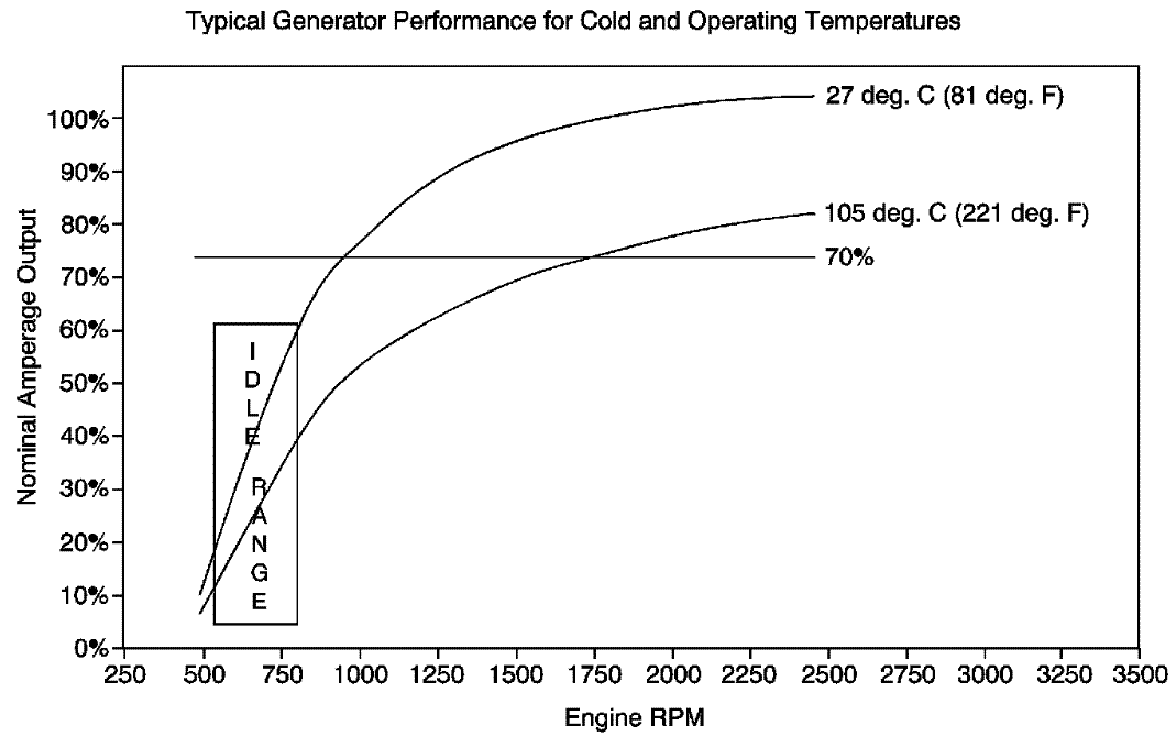

550-650 is the normal warm idle speed. 500 would be low enough to drop alternator output by quite a bit. Maybe "very low" was a poor choice of words.
Here is a plot of alternator output (%) vs. RPM for cold and operating temps:
As you can see, the last 50RPM serves a drop of 10% in output. With a 100A alternator, that is the difference between 20A output at idle and 10A.
But the battery being dead in the morning may be caused by a current draw on the system even after the key is turned off.
