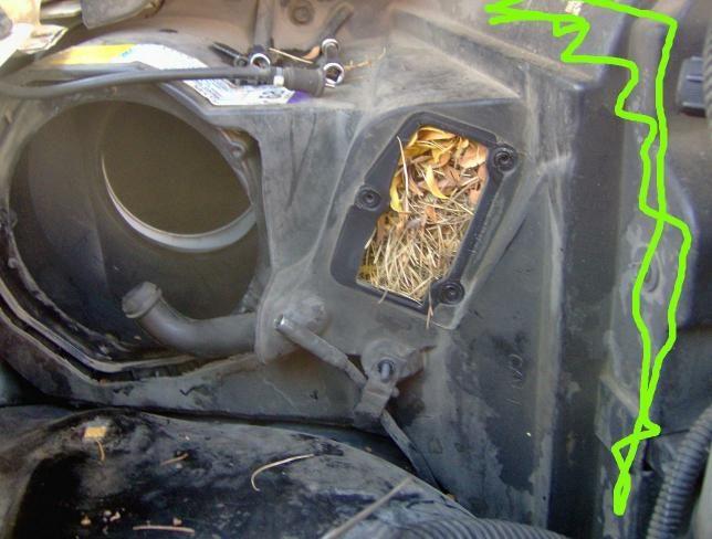

When you replace it, be sure to take the opportunity to clean out any debris that has accumulated inside the the compartment and inlet to the AC evaporator.
Also, be careful with cutting out the cover for the blower. There is a drain hose for the motor body that you will want to keep. (you can see it in my picture below) The replacement one that came with my blower motor did not fit.
Then when you replace the plastic cover, be sure to use a sealant (RTV or whatever) that does not give off corrosive fumes. This can damage anything electronic. I'm thinking most RTV products now are electronics safe but just be sure to check.
I have the Computer Climate Control and as such there is an solid-state sensor you can remove to gain even more access to the area at the inlet to the evaporator. I found LOTS of little leaves and larch needles in there. It attaches to the right of the blower motor when looking from the front of the truck. Its opening is the one with all of the leaves and needles in the picutre.
If you don't have the Computer Climate Control, this sensor is replaced by a resistor network that is mounted to the top of the compartment on the exit side of the evaporator.
The green lines are where the evaporator is.

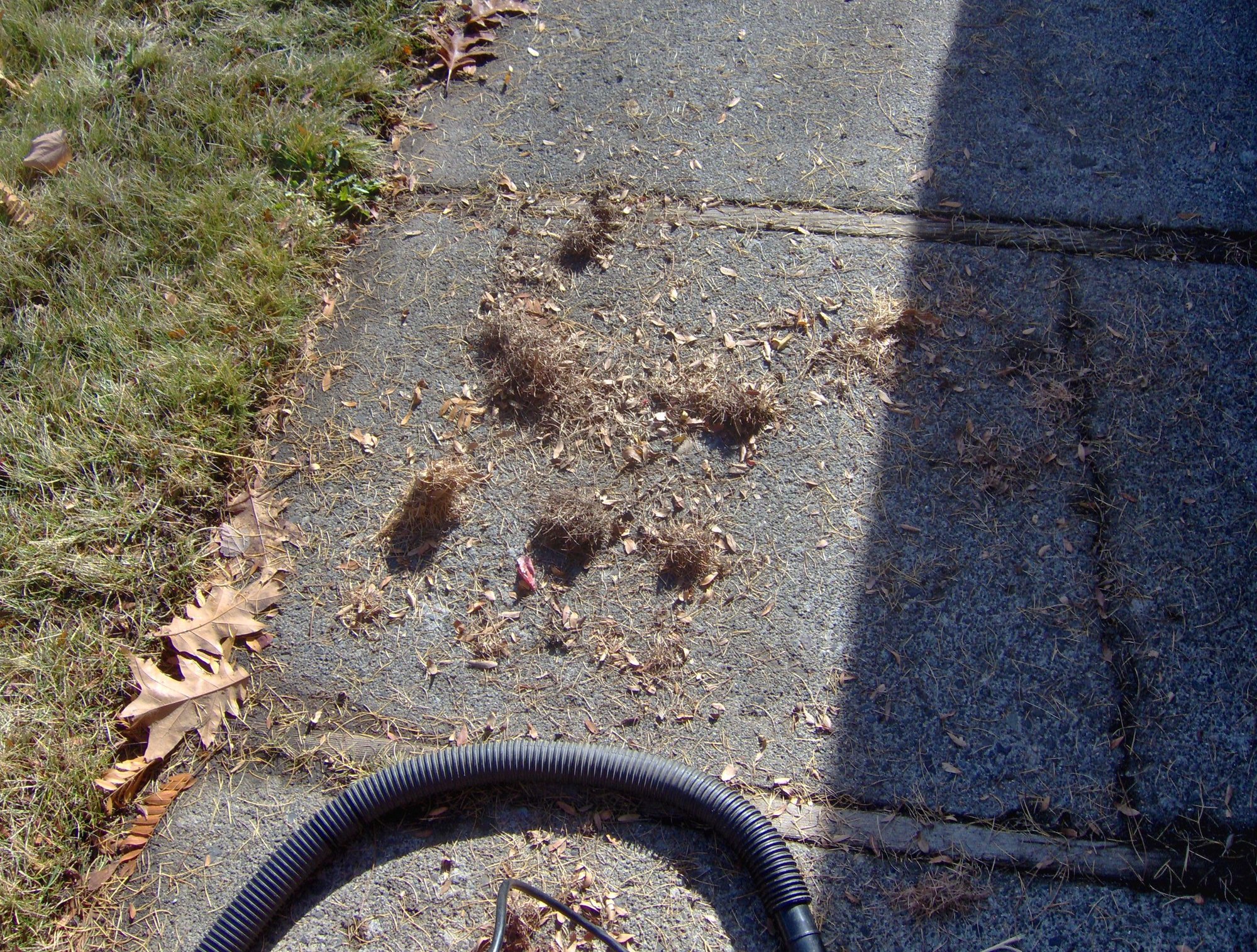

Some of the needles and leaves I pulled out by hand. Much more was in my shop vac!
